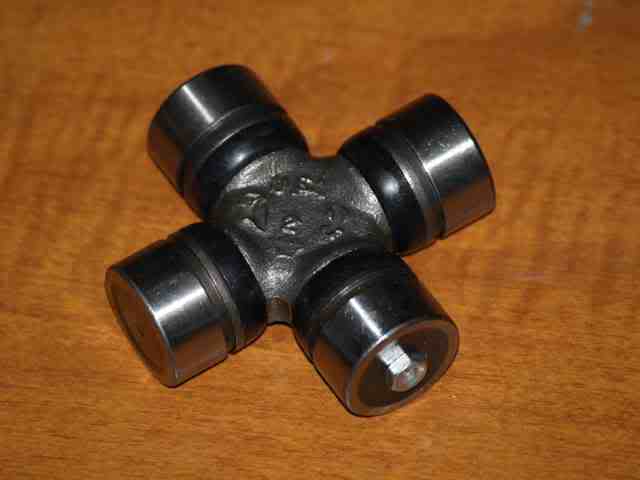

If you're talking about one of these:
That's what I use with the flush fittings I use on u-joints:

thanks !! for the pics AC, the second one is the answer, and yes you can grease a typical zerk with it tou just have to be centered on the "ball" of the fitting

Yeah, it'll work on a "standard" zerk, just a PITA. They are really meant for flush fittings as pictured.
