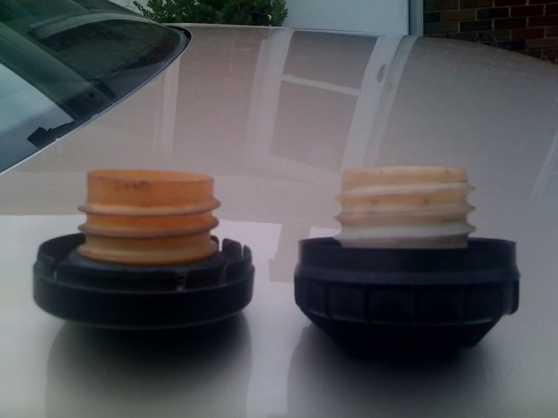

Any gas cap should fit, provided its from a similar year model.
Old 60's gas caps are of course diffrent, but look here at these pictures
one is from my DISCO, one is from a 2000 Toyota Camry..
Can you tell which one is which?? No and probably neither will the car.

Most importantly is get someone to help you get the old one off and then just get any old gas cap that will fit.

Pancho-The one on the right side of the first pic is from your Disco.
Here is what you do Annie, tommorrow go and test drive another DII, while on the test drive remove their gas cap...j/k.
He is right though, does not need to be a LR gas cap.
