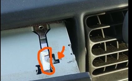

Specifically, getting that center stack out can be a bit tricky and they are extremely notorious for cracking/breaking when someone doesn’t pay enough attention in removal. This is what it looks like fully removed.
For the switch pack and the central lock side pods, there are 3 screws on each side behind them. There is one behind the head unit on the top middle of the center stack and also at least one on each side after you remove the ash tray and coin holder on each side.
The hardest part is getting the HVAC controls and the switch/central lock pods out. It is very tricky and feels like you are going to break them. Using butter knives for the HVAC controls and a credit card for the central lock pod seem to be the best way based on YouTube videos.
Once all that is out, you have to be very careful not to break anything (I’d say odds are not good that none of that is broken already). After that, you have enough space for a party in there. The things to keep in mind is remembering all the connections for the stuff you removed: 2 for the central locks, 3 for the HVAC, and possibly 5 for the switch pod. This is in addition to the radio connections.
