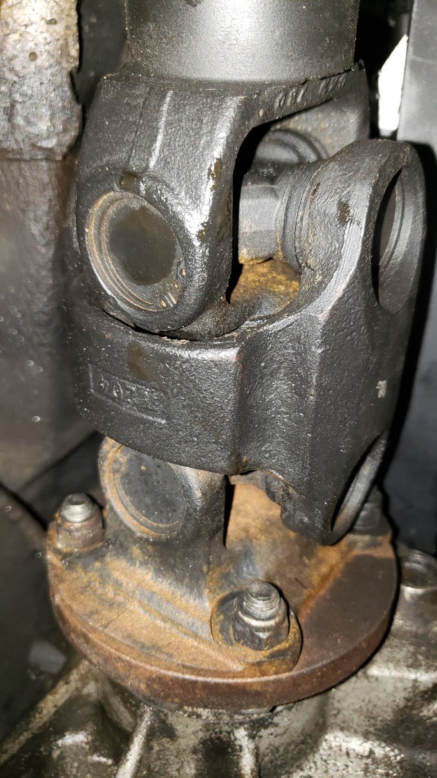

So I crawled under it to check the driveshaft. The good news, I guess, is that there's no movement in the double cardan joint and the bearing caps aren't deformed. The bad news... well:
Let's just say it has some patina.

@Jason Feuerstein they all get that way eventually do all the rubber caps look good ?

They all look great, actually. There's wrecker writing on it, so it's not the original drive shaft, but this car has no records, so there's no way to tell how long ago it was replaced.

Looks good to me, just check your fluid levels before each days travel & enjoy your trip!
