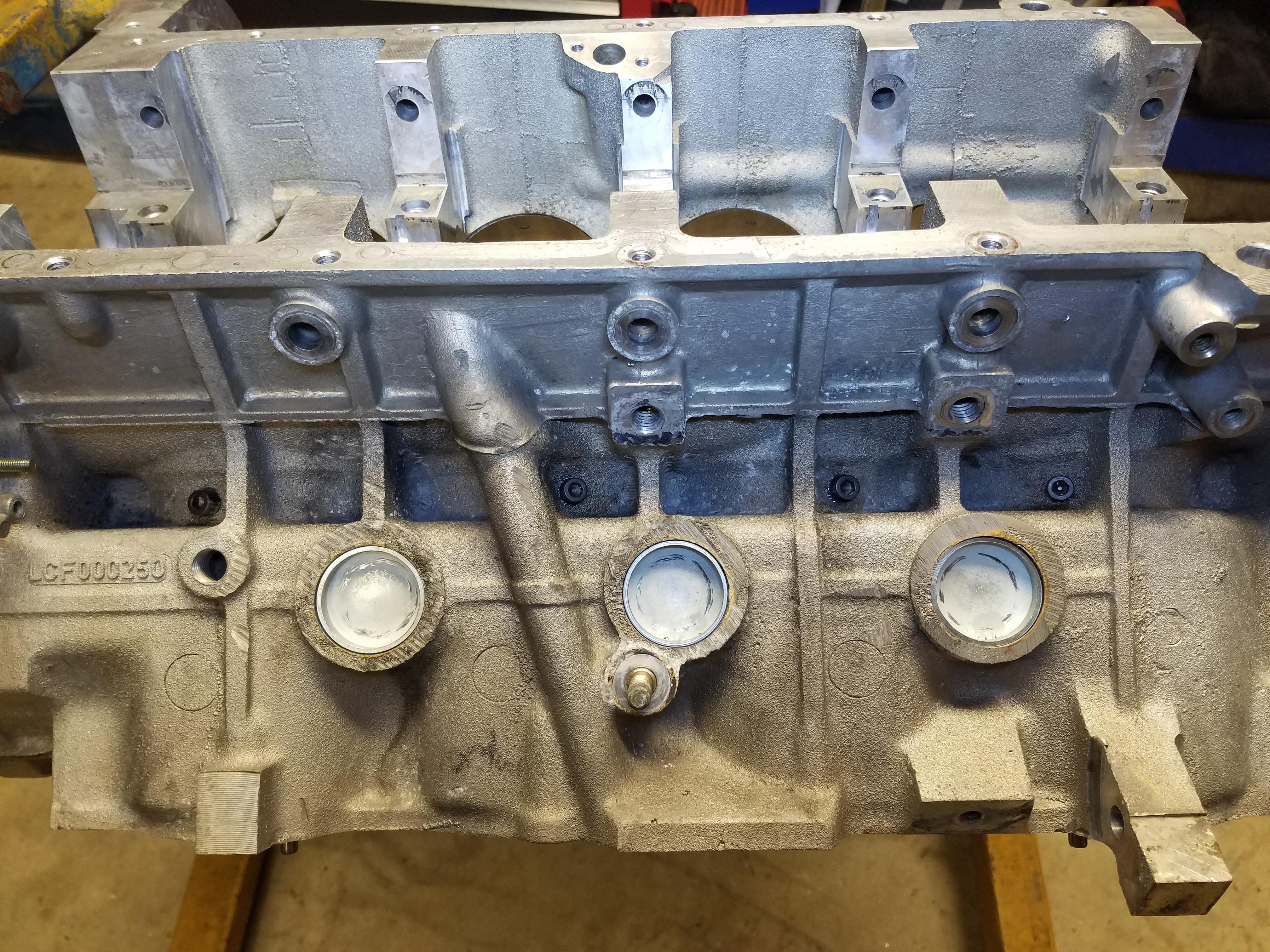

Originally Posted by Davis31052
If this is your end goal, rebuild it with pinned liners or flanged. Anything less is a patch job. I'm not being a smart ***. I just know from experience. Good Luck.
+1
Now that my engine is apart, I am pretty sure none of the liners in the block had slipped...but I pinned all 8 for piece of mind.
Cheap and easy.
There is a thread here with details, and what we followed.

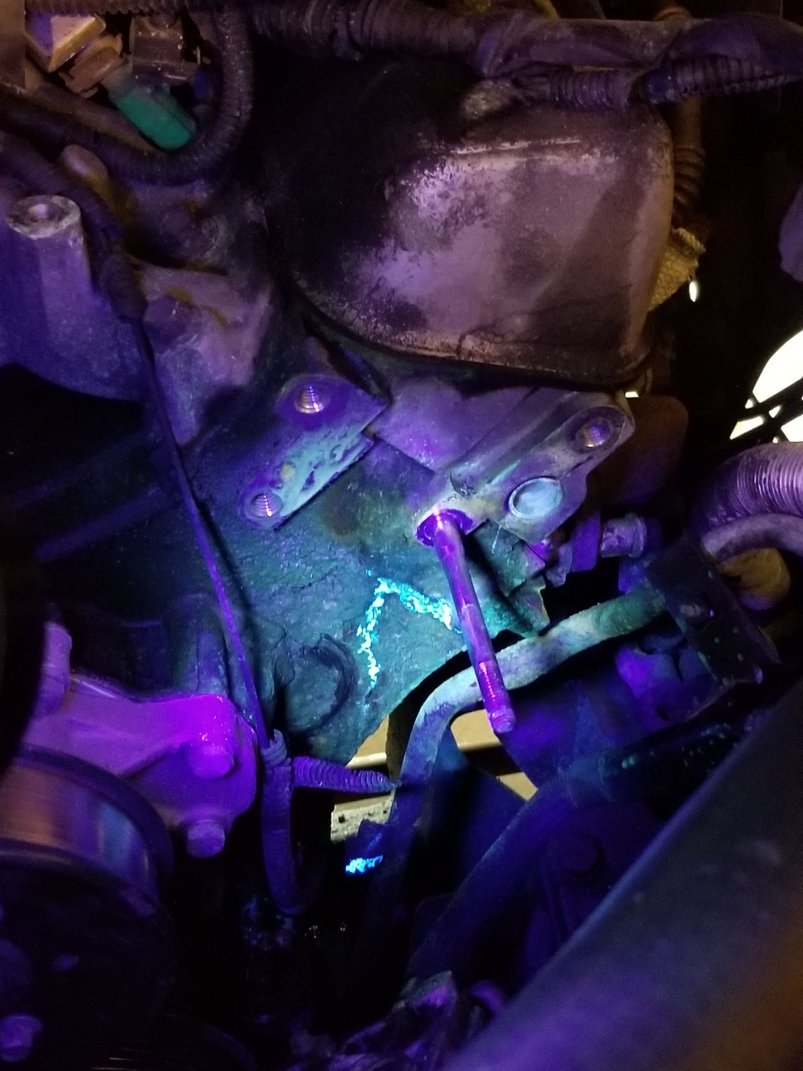

Found out where my leak is, i used uv dye and found it leaking out of the front of the drivers side cylinder head, i also found out that my power steering pump is shot. so its gonna be parked for awhile until i get this mess all fixed up
