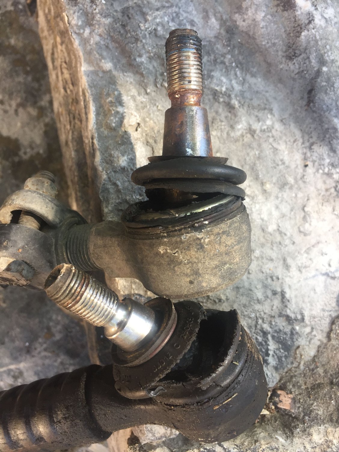

Check your tie rod and drag link. If they look like this, its going to steer hard and possibly lock-up.
Tie rod and drag link boots destroyed. No lube. Locked up when recovering from a left hand turn. Some on the other side.
