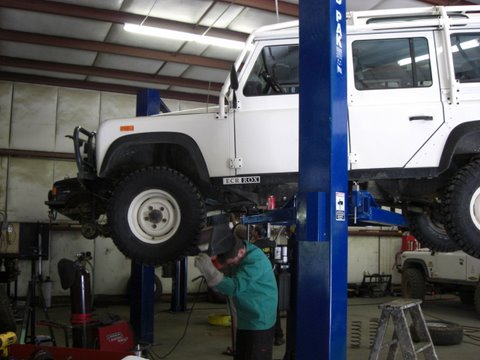

From: Kirkland,WA
Originally Posted by mag48
Where should you mount the four points?
do the arms extend at all on your lift?
in the rover shop i go to they lift from the chassis.
copy this,,,
