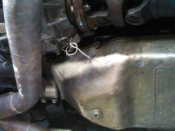

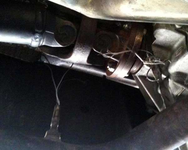

While on my photo safari in New Mexico it became evident that my transfer case leak had come back. I had gear oil added to the case by 2 oil change shops while in Socorro to keep it safe and made it to Albuquerque and went to the LR dealer there on Wednesday. They did a check out and informed that I really needed a complete transfer case reseal job as oil was leaking pretty well from my input and rear shafts as well as the access plate gasket (RTV cement) that I had paid $350 to the dealer in Shreeveport a month earlier while driving from Atlanta to Houston. They said they would do a complete reseal, every gasket and seal and it would cost around $1100.00 and it would carry a one year warranty. The labor involved seems pretty intense to get the case off and I do not have a lift at home or the right kind of jack or support and possibly all of the tools I need. I agreed as I needed to get myself and my wife back to Texas for the upcoming work week and I felt really uncomfortable driving 1000 miles and not knowing if I was leaking so bad as to ruin my transfer case.
It took a day and a half and I had the added expense of a rental car to get around in. I picked it up Friday morning and upon driving off, my wife noticed that the exhaust seemed a little louder on the passenger side just under her feet when it was first started up and it was cold. We had a very tight schedule which did not allow us to return to the dealer to check it and the noise seemed to disappear as the system heated up. I was almost back to Houston when my check engine light came on (which has never happened since I owned it). I got home fine and this morning checked out my car. I use the CarChip device to keep track of the running status of my car and usually leave it plugged into the OBDII plug in the dash. I hooked it to my laptop and it gave me several codes regarding the O2 sensors. I was surprised as I had replaced all the O2 sensors a year ago as precautionary maintenance. So I got under the car to look around and found that the right rear sensor wire is completely ripped away from the O2sensor and it must have been not secured or routed correctly by the mechanic in NM and it got picked up by the Cardon joint of my front shaft which ripped it in 2 in an instant. See pics.

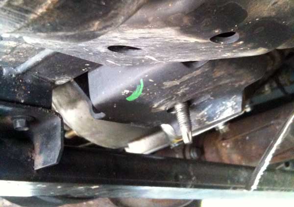

I also noticed that their is a support nut missing (which may have just come off or never been put back on) and I assume the exhaust noise is from some joint in the Y exhaust pipe as this has to be removed to get the transfer case down. The noise is worse when cold and goes away when it is hot so it may be a bad exhause gasket or poorly tightened fitting.

I've attached some pics.

Sorry to hear of your ordeal man. A lot of Dealers out there are hurting, so it's no surprise you're getting the run around by the Houston dealer. My gut feeling is that since it's not a "Land Rover Vehicle warranty issue", but rather an individual dealership repair issue; your only recourse will be with the dealer in New Mexico. That New Mexico dealer is likely to tell you 'Bring it in and we'll take care of it". Normally that's an acceptable offer, but it's doubtful you want to make a trip back to New Mexico to have them put a few bits back together while you wait another day, get a hotel & rental, and spend all that time driving across West Texas. Having seen how these things tend to go, you're likely to end up footing the bill.

Well...your dealer will charge you the $120 just to look at your truck, they did not work on it to begin with so that is understandable.
BUT, since the work was done by a dealer they should cover the cost needed to correct the other dealers screw up as long as you did not go past the warranty period.
Call the dealer that worked on your truck, play nice, you get more fly's with honey than vinegar.
If they wont play ball then it is time to get nasty.
Your dealer should be more than happy to work with you, hell, they get to bill the other guys for whatever they want.
But since they did not screw up the work they are fully entitled to your $120, if they want to be nice and wave it or try and collect it from the other dealer thats up to them.
And just a FYI, there is no need to remove the t-case from the truck to reseal it, it can all be done in your garage as long as you have the tools needed to remove and replace the seals.
There are 3 front out put, rear out put, and the inspection cover.
