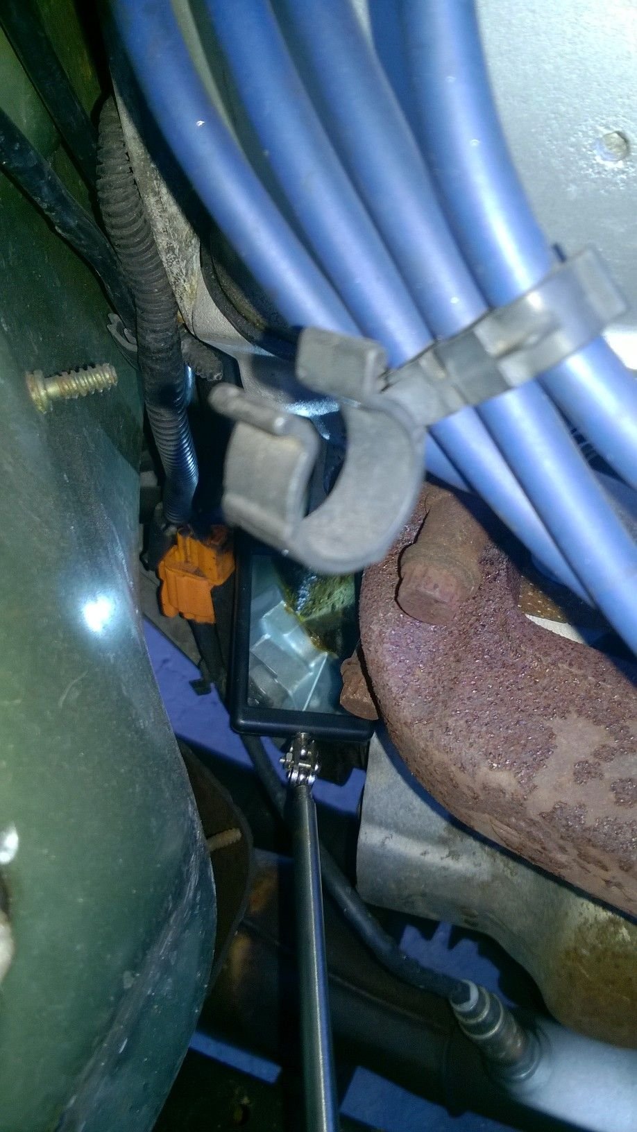

Got some time to do some diagnosis.
Truck was cool and hooked up the pressure tester. Ran it for a while. Never got over 5 psi. This does not explain why the expansion tank cap vents/relieves pressure.
Below is a photo of the coolant leak. The mirror shows the rear corner of the pass side head.
My game plan:
Retorque head studs, if that doesn't do anything (I don't think it will help). Then I will install a new headgasket on the pass side head.
My game plan:
I had a leak in that same spot. It went away... for a little while (few hours) after I filled up with coolant. When I got home I checked the rear head bolts and they were tight (since we don't get torque specs it is hard to know HOW TIGHT) so I gave them another 1/4 turn just because.
Best of luck with that. Sounds like you know just what to do. When the inevitable occurs use copper gasket compound (spray) on both sides of the gasket and you'll get a better seal.
FWIW, I only installed the passenger side gasket, too. I haven't had a problem since on that engine.
