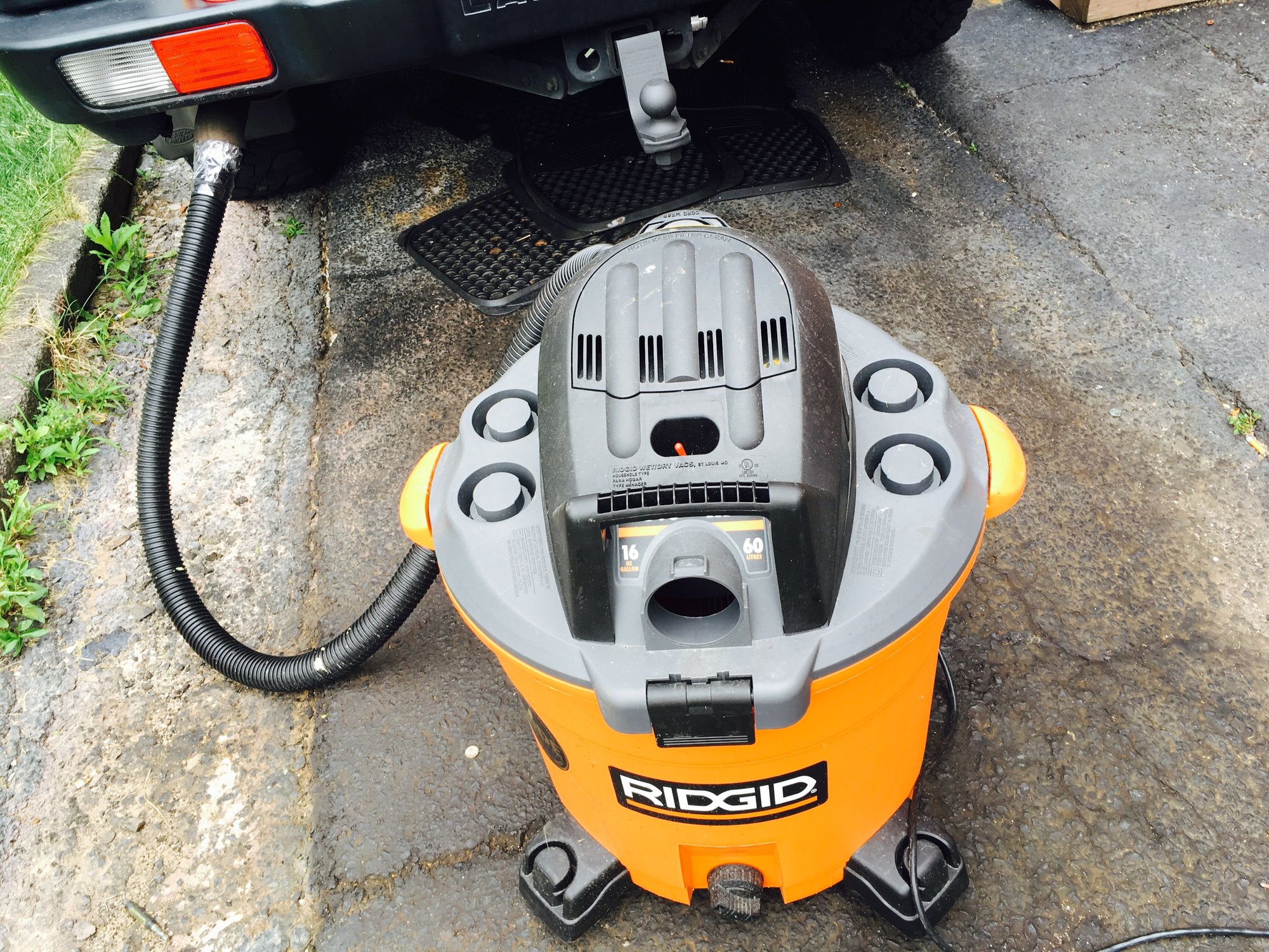

Try this. This will definitely be better especially with manifold leak than when the engine is running and plugging the exhaust with a wet towel. When the engine is running and the fan turns, air is alover the place. This you can feel all the gaps and leak alover withoit a smoke tester with this method.

Great idea!
You could probably still have someone blow cigar smoke into the vacuum inlet while you inspect the engine bay...

The shop vac method is excellent. I used it to confirm an exhaust manifold to down pipe leak last fall. With the shop vac blowing into the tail pipe I sprayed soapy water around the suspect areas. It was easy to see where the leak was. I didn't need to use duct tape at the tail pipe. I just jammed the shop vac hose into the tail pipe.
