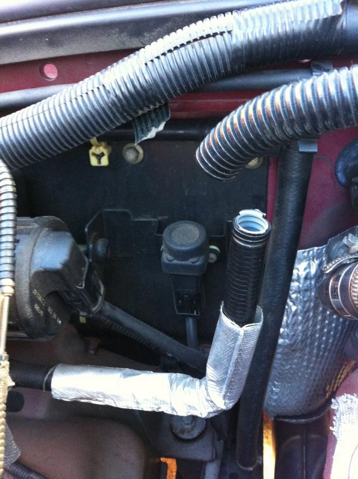

I started a head gasket replacement this afternoon that I will pick up tomorrow. Everything has been pretty straight forward but I do have a couple of quick questions.
(1) I broke the upper pipe (photo below) leading to the secondary air tube on the passenger side while trying to free the secondary air valve. Any suggestions on a repair? Does this mean a new part or can I replace it with something a little more flexible? I have to admit, secondary air makes most tasks a PITA. Is there really a benefit to the system? Can I just remove it and plug the inlets on the head?

Thanks for the replies. Looking at new posts, there seem to be a ton of people replacing head gaskets at the moment. I have been working slowly and following RAVE, but somehow I managed to break those pipes (could the cold temp have something to do with it?). I still cant find the part on either AB or Rovers North. I may check out Home Depot if all else fails.

#1 - I broke mine as well...brittle piece of crap...
...I taped it together with gorilla tape about 4 weeks ago and haven't gotten around to replacing it yet...you should be able to replace it with any type of lightweight flexible hose from any hardware store...no high temp air passes through it and you can reuse that fliexible heat shield covering on whatever you replace it with.
I wanted to give an update on how I permanently fixed this on mine just in case it can help out anyone else -
I bought a section of 3/4" heater hose, reused the quick disconnect fitting on the SAI pump side, and ran it from that fitting straight to the metal SAI tubing...I secured the section of heater hose to the quick disconnect fitting and the SAI tube end using regular worm type clamps.
Works well so far and now I don't have to worry about breaking that brittle pipe into any more pieces.
Total cost of repair ~$5

Thanks for the help. Quick question, I didn't reallylook at it but how exactly does the quick disconnect come off? Push, pull, twist, or all three? I spent 10 seconds trying to get it off and quit!
Old Jan 17, 2011 | 12:42 PM
Disconoobie's Avatar
Joined: Nov 2007
Posts: 135
TBH I'm not sure...I did a combination of the 3 for a good 2-3 minutes before it popped off.
