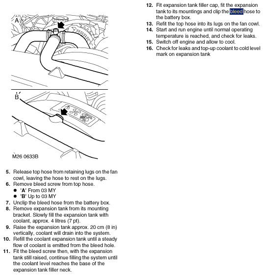

I always test new thermostats before installing them. Most are fine, but I have had bad ones.
Here're the steps for bleeding the cooling system:
Do you know why the head gaskets went? Usually the go from overheating. Do you know if the viscous clutch for the fan is good? I'd definitely test it to make sure. You can get them locally if it's bad.

Key words are "slowly fill expansion tank." Also, make sure you do this when the engine is off. If you try it while it's running, your expansion tank will become a geyser!
