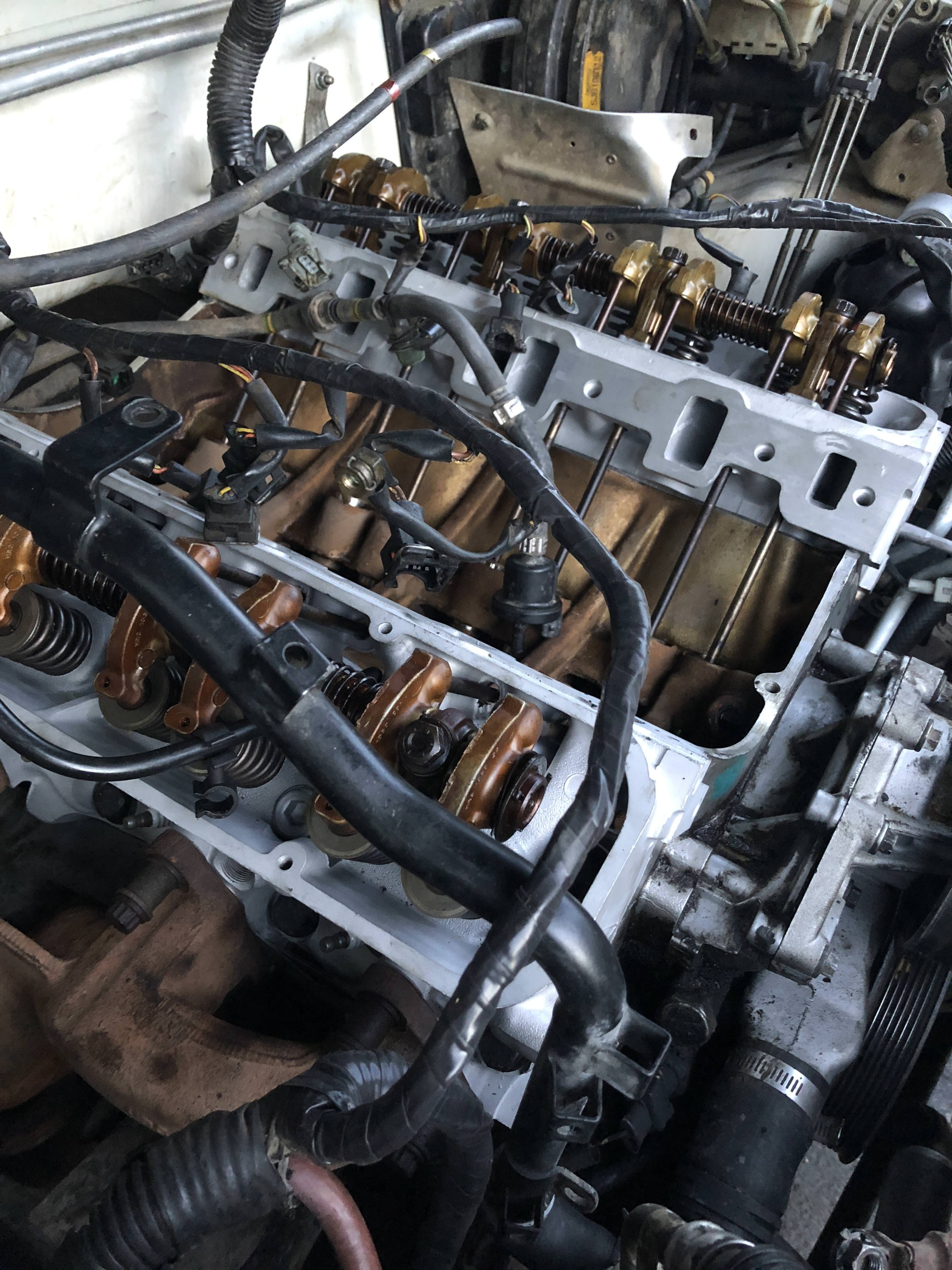

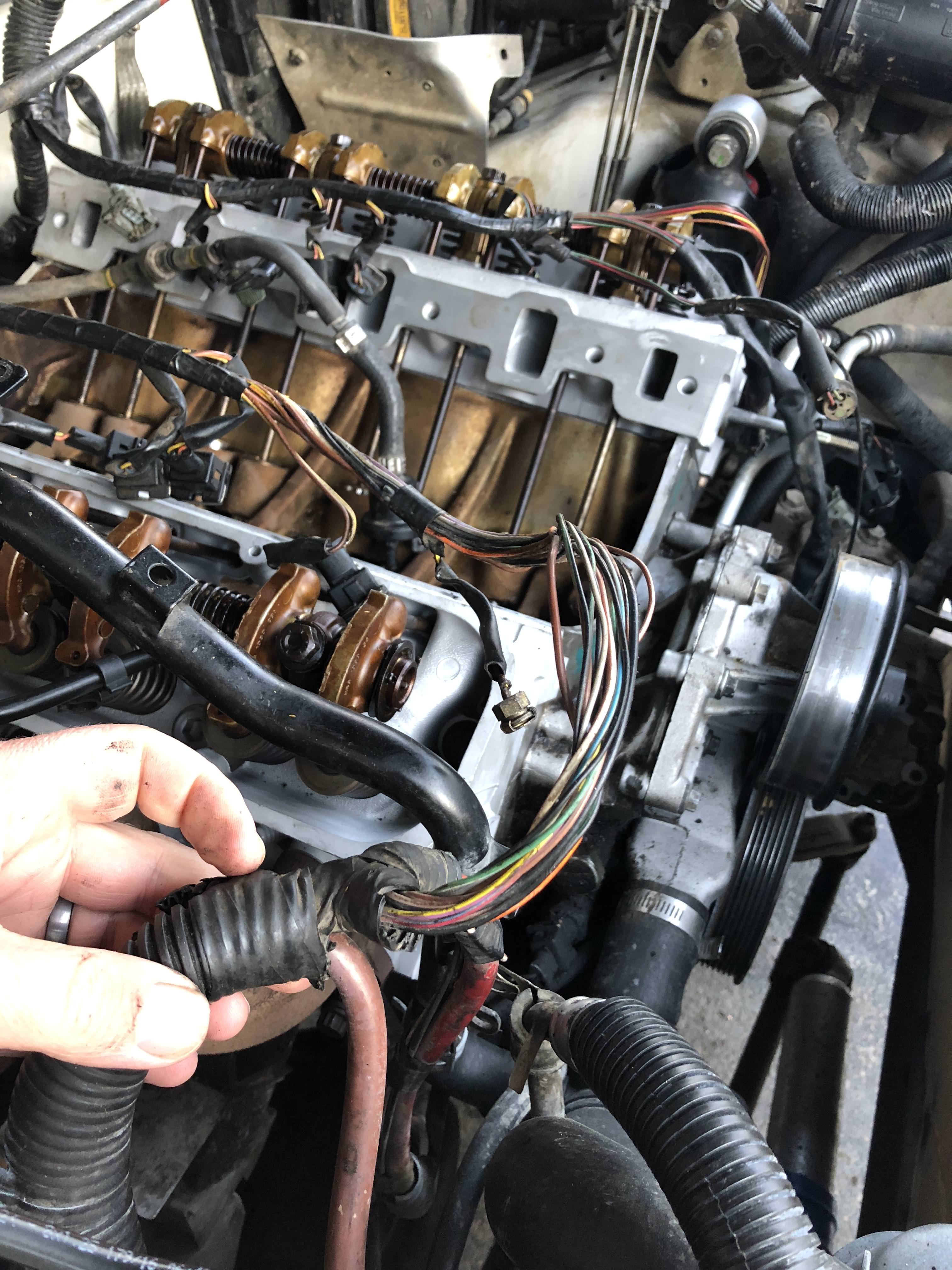

The wiring coming out of the fuse box to the engine has been an absolute tangle. Someone had everything disjointed. Got everything going in the right directions. Put new loom on the positive feed to the Alternator and the wiring to what I think is the cam shaft sensor or whatever is underneath the center pulley.
Got my throttle body cleaned up and somewhat derusted.

Jah, the cam sensor is the single wired one that is under the center pulley.
mine was caked with sludge and the protective loom was crispy. I cut it off and put some fresh loom on it, and taped up the connector so less funk would get in. Man, it’s nasty down there.
