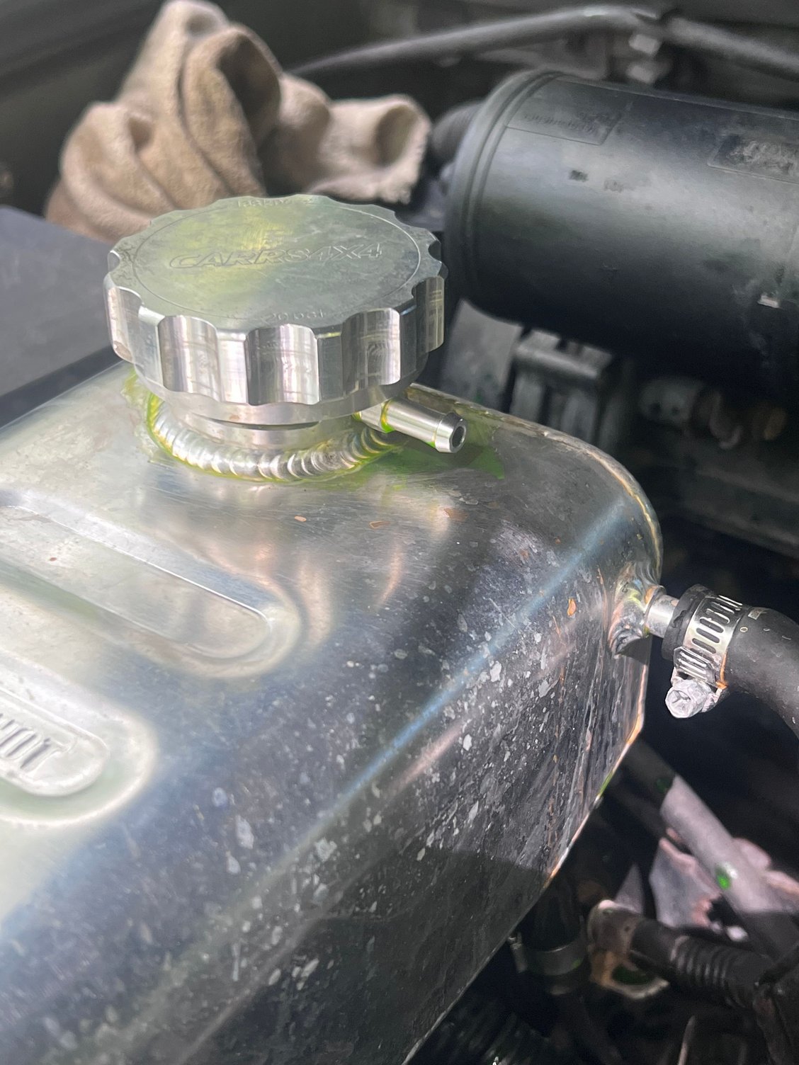

I’d spotted a little coolant weeping from pass/rear head a few months ago.
Started running no pressure cooling system which stopped that.
Now I’ve discovered a coolant explosion inside engine bay, after a mild overheat (UG read 205) which was suspicious, as I never get that hot.
Now it’s starting to overheat at 1500 rpm standing in the driveway.
Rear of the same head looks to be wet again, although could have been from the coolant from the cap.

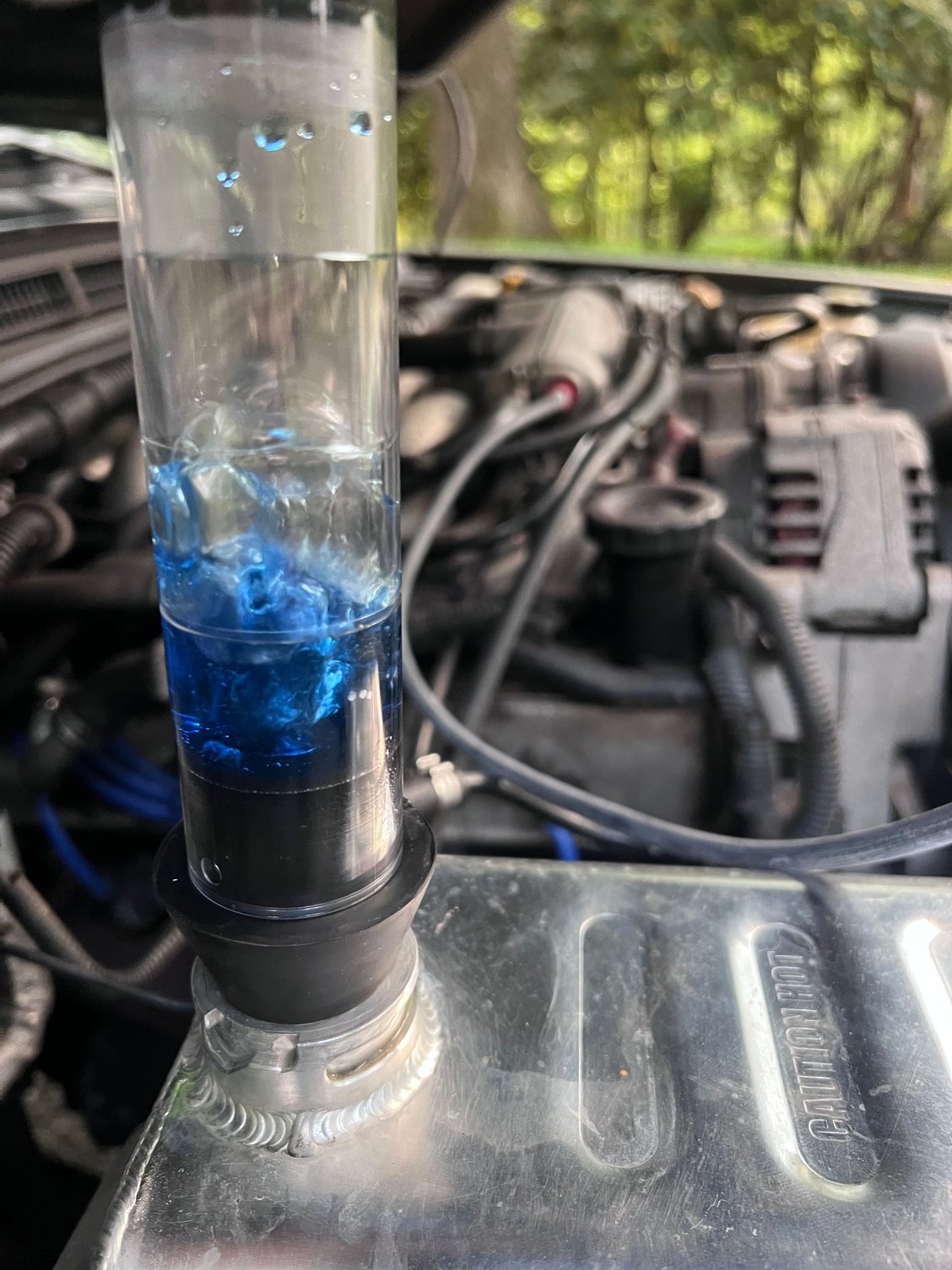

Describe the coolant explosion location, you can also get an exhaust gas test kit which will tell you if you exhaust gases in the coolant.

Coolant came from filler cap.
So I guessed that combustion gases are entering coolant. I can go get a test kit for that this afternoon.
It took about half a gallon to refil.
When I run it and watch I just see the temp climb. But not push out of the cap.

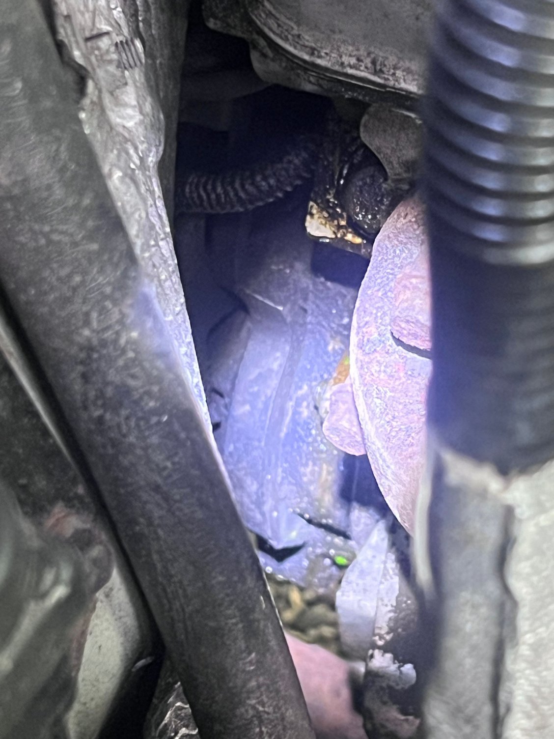

There has been coolant from rear of passenger head in the past. I’d cleaned the area and was watching, nothing, then this.

And, couldn't get the blue fluid test to show positive either.

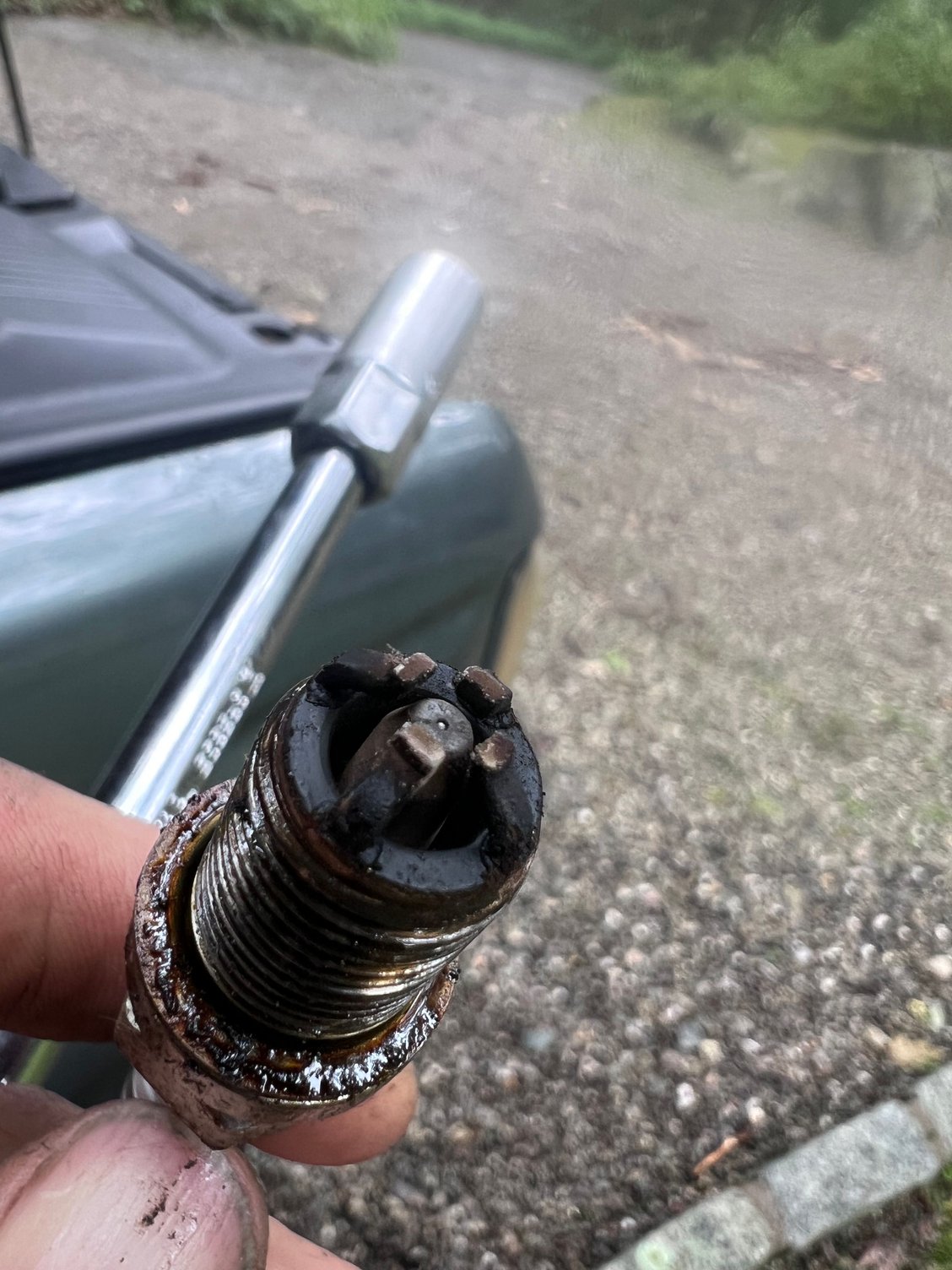

Hmm, possibly yes. You think I might see evidence of the coolant inside the cylinder? Check the one closest to where I see coolant on the outside? I have one of those things that you stick in your ears to check for wax, connects to your phone. Great tool for those wanting to scrape their own ears BTW. And we all arn't getting younger.
I can also check to see if that plug is steam cleaned, compared to the rest I guess.

They don't always blow white smoke if the leak is small. They don't always fail the combustion gas test. And they don't always fail a pressure test. But a pressure test is a good test. I had one that blew a head gasket, slight blow, not big. No white smoke, no combustion gas, but an overnight pressure test failed and it put enough coolant in the cylinder to hydrolock it - had to remove the spark plug to get it to turn over. Had another one crack a cylinder, put a teaspoon of coolant in the cylinder from a pressure test that we could see. IMO pressure test is the best test. And yes with a bore scope you can typically see the one cylinder is much cleaner on the piston top if the hg is blown.

Blue dye test still good.
My boroscope wasn’t good enough to see anything, although the plug in the suspect cylinder is fine.
Still a little evidence of coolant at rear of pass head.
