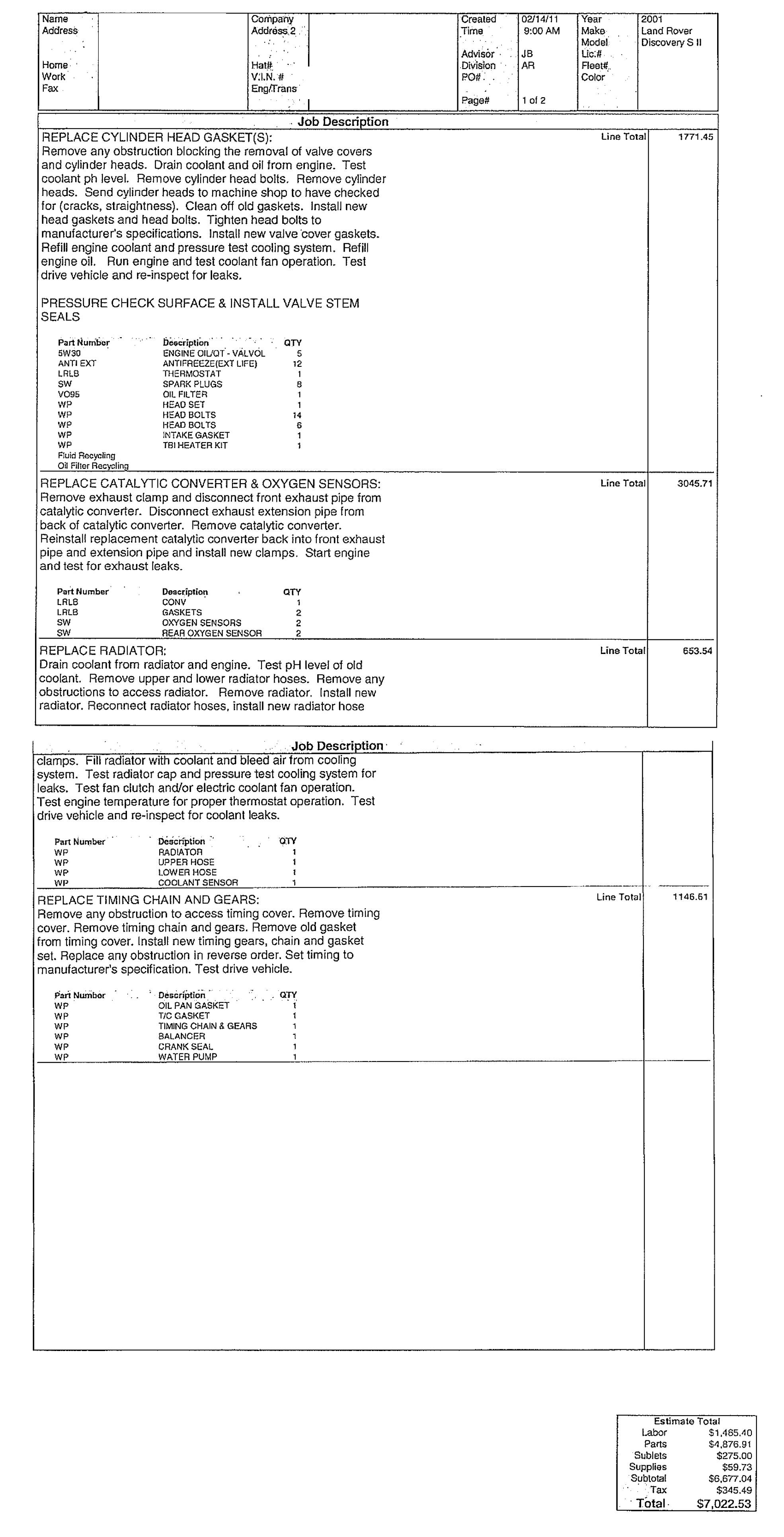

Here's the quote it is brutal.

Old Mar 1, 2011 | 10:50 PM
DiscoIIBrandon's Avatar
Joined: Jul 2010
Posts: 435
From: Lakeland, FL
Default Yikes!
Thanks for posting. This should help everyone in giving you advice.
Again, I'd get all of the actual codes and post them here as well. I don't know much, but it appears he's just replacing everything that could be causing a problem.
RED FLAG (to me):
$3,045 for 1 cat, (4) o2 sensors, and 2 manifold to y-pipe gaskets.
You could get an entire new exhaust system with cats, muffler, y-pipe, o2's, gaskets, etc for less than that and bolt on.
For example, universal cats will cost you around $70 each. The o2 sensors are $70ea. The 2 gaskets are about $6/ea. It looks like he is just going to cut the old cat out and weld in another. Shouldn't be more than $100ish for the cut & weld job, IMO.

Yeah, I asked to see where the radiator was leaking and sure enough when I picked it up it was off the lift and sitting out front which just struck me as shady since I made a special call requesting that I be able to look at the Radiator issue (seemed like that was not my problem) I don't know the history of the vehicle very well -I bought it for dirt cheap a year ago w/ a Lemon title out of California. I figured I would take a gamble on this one and I got about 45k miles out if before it started overheating. I towed a boat up to Canada with it and generally drove it non-stop so I'm not too upset with it dying on me. I'd really like to fix it but these numbers seem way out of line and I seriously doubt all these things are bad and need to be replaced. If anyone has any other advice I would greatly appreciate it. Thanks!! I took it to Auto-Zone and asked for the codes and they couldn't figure out how to read them. I didn't know where the connection was and obviously they didn't either. Total fail on the codes.

You can definitely do better on the Cats and the radiator if those parts really need to be replaced.
Also, why are they replacing the timing chain and gears? At 123k miles they might be a little loose, but if they aren't broken they shouldn't need replaced at this point...
These guys sound like crooks or a shop that has more business than it can handle. Take your truck to another independent Rover shop.
