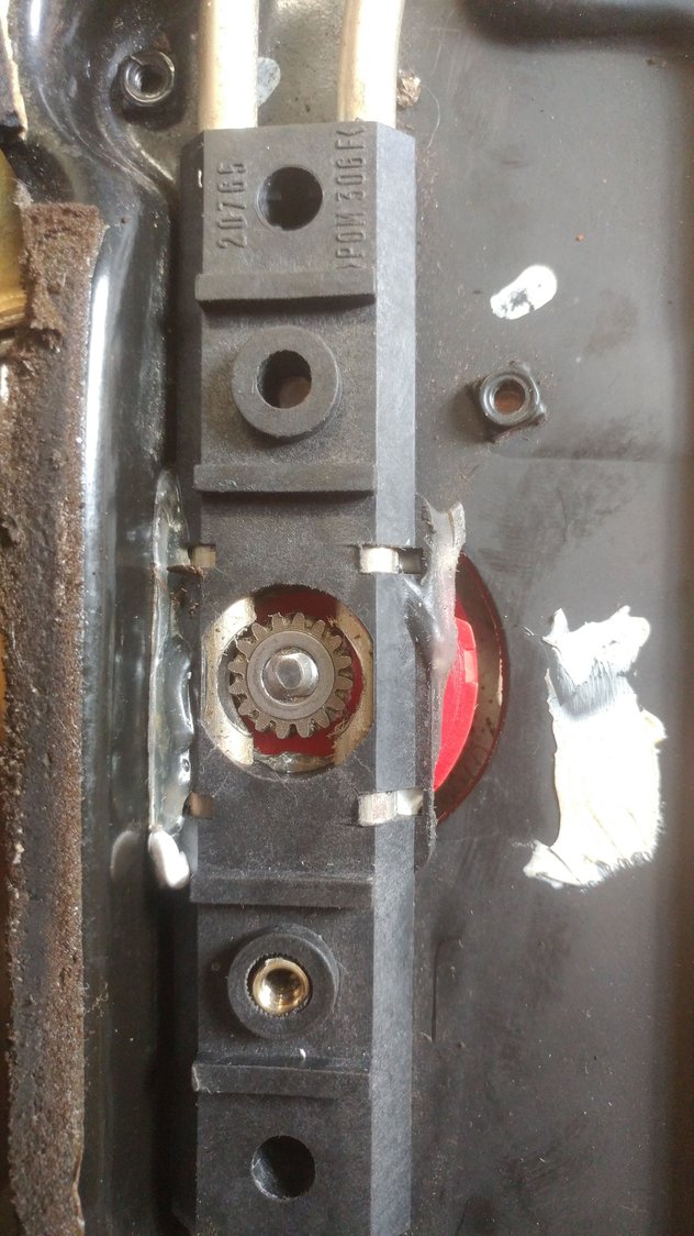

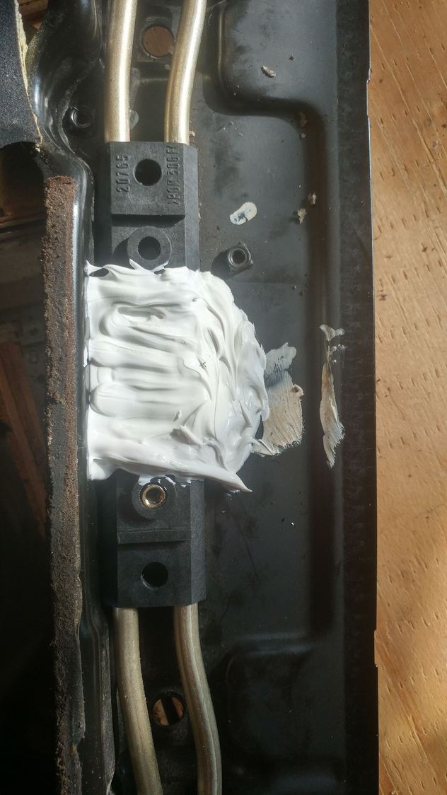

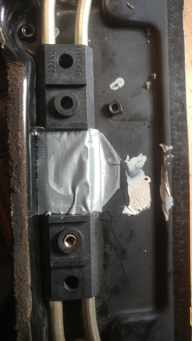

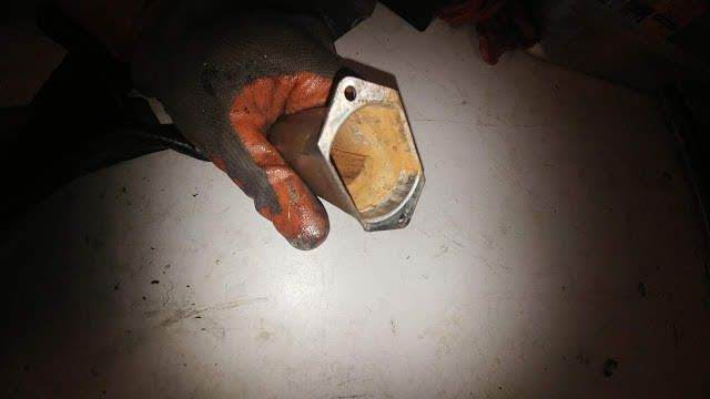

I paint the top of the headliner board with stainblocking oil base paint - any future leaks will not get through to the fabric. I then seal the edges of the fabric with clear silicone. I recommend removing the sunroof pans and resealing the drain cups to the pan. While out, remove the sunroof cable assembly and seal the bottom of the assembly to the pan. Then cover the hole in the top of the cable assembly with tape and seal over the top of it with silicone. Disassemble the sunroof motors, clean them out, and then reassemble with a liberal coating of grease to prevent future seizure. One of the key leak areas is around the sunroof motor
Remove this and seal it to the pan
Then cover the hole with tape
Then seal the entire thing with silicone all over it.
Seal the drain cups with silicone top and bottom
