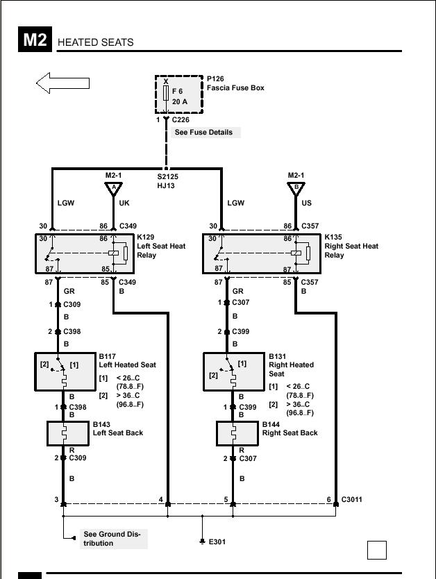

did you look at the electircal diagrams in RAVE?
Old Dec 17, 2009 | 05:59 PM
okdiscoguy's Avatar
Joined: Feb 2007
Posts: 4,959
Likes: 11
From: Tulsa, OK
diagram.... find the relays and listen..

Thanks okdiscoguy. I went back and looked at RAVE and discovered I was looking at the english version instead of export version for the 97. Once in the export version I found M2, which was missing in the english version.
