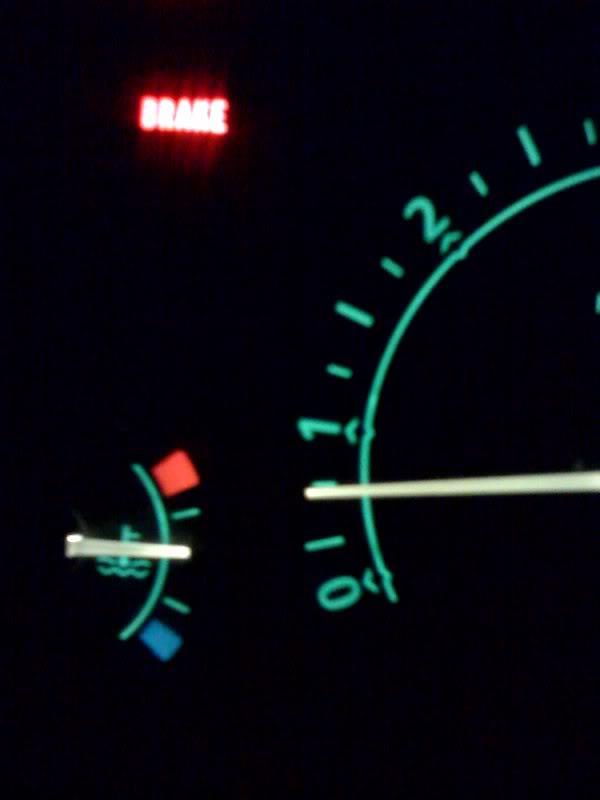

I took it for a drive for about 15 minutes. Took it down our dirt road, then down the highway. I didn't push it hard, but harder than usual- maybe 3500rpm max.
Putted down the dirt road. Putted down the drive way (1/4 mile or so). As soon as I come to rest, I snap this picture of the temperature gauge:
NORMAL TEMP: Name:  normal.jpg

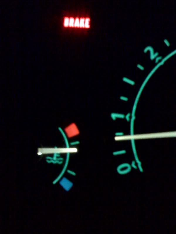

Then almost immediately, it starts warming up, exactly like it did before. I let it idle, and it kept climbing. It climaxed, and seemed to sit there. Here is where it looked like. This is very abnormal for my Disco. It always sits in the "Normal" position above.
CLIMAX: Name:  extreme.jpg
It sat there for 30 seconds. I decided it wasn't going to go any higher. So, keeping it parked, I revved it to 2500 RPM. I let it hand there for about 15 seconds, when the temp dropped slightly.
I let it idle for 5 minutes, and it sat in this same position. Still above normal, but not as high as the climax.

What do you guys think?
These gauges aren't very accurate, of course. I usually find that it's either all or nothing with these... but in this case, there seems to be an equilibrium.
Please tell me your thoughts, guys... I really don't want to ruin this brand new block. Atlantic British said these new blocks CANNOT shed cylinder sleeves...
Again- please tell me whatever thoughts you have, friends. Thanks guys.
