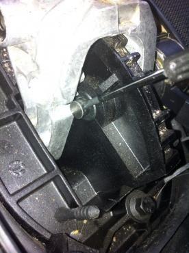

Carefully pry the bezel up and out of the way and push this pin to the R. If the truck is running, then this has nothing to do with the security system. Could be a bad brake switch.

UPDATE: got in consul;e, pushed in the solenoid by hand and truck will now move. Looked up on forum and saw the Brake Switch as the MIGHT BE. Will check that when I have help
