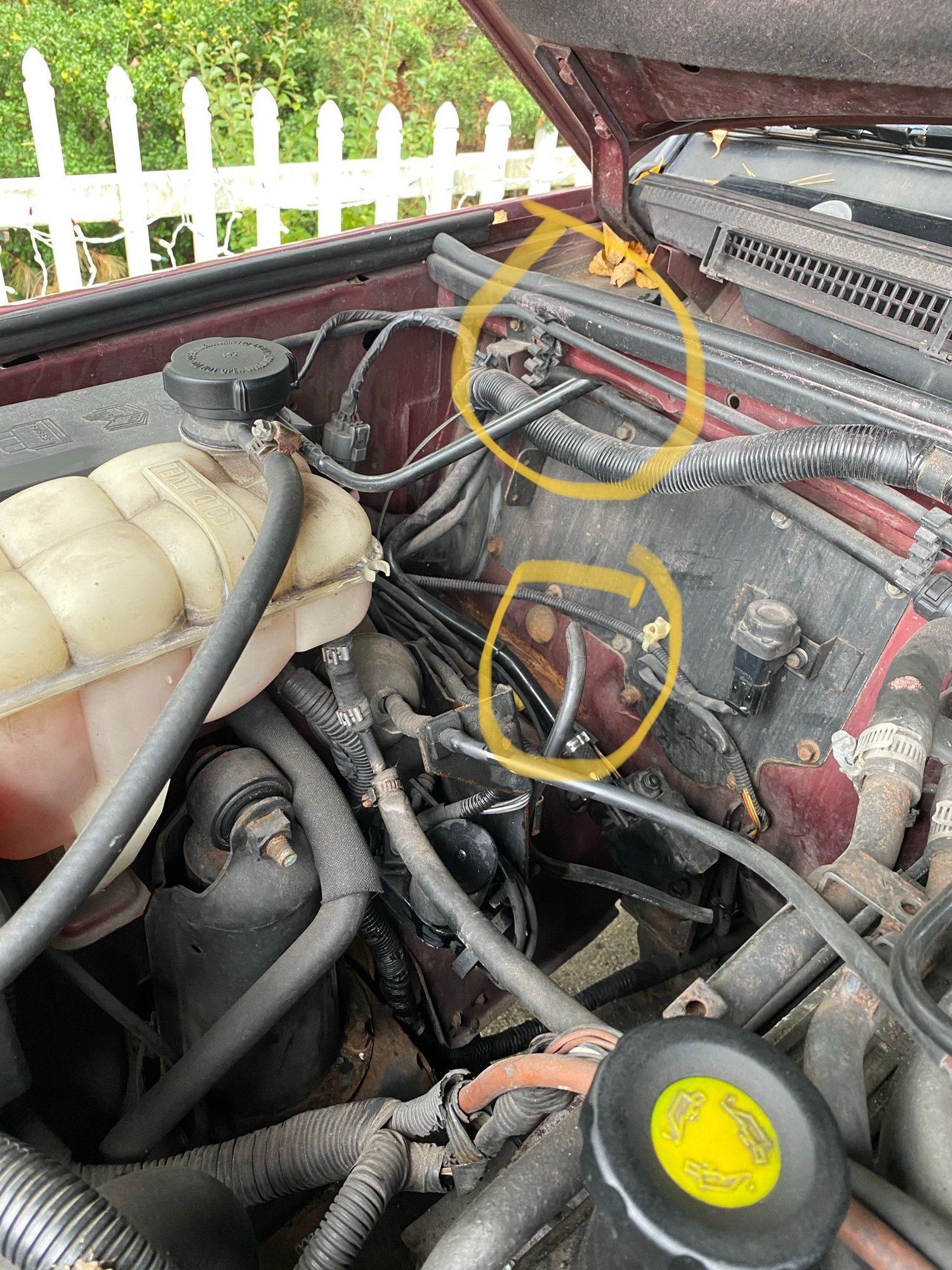

so I bought my 2000 disco 2 about 9 months ago and just realized, a hose from the coolant res is broke in half and it seems like a huge empty spot in that general area.
My question is:
what is that hose in yellow?
guessing I need to fix that?
the car isn’t running hot or anything but that coolant in the res seems to be draining slowly, very slowly. Nothing leaks out of the busted hose tho.
thanks for the help.

Nothing is amiss.
The nylon line running from the reservoir is the overflow. It should be rotated to point down and mounted in the little clip pictured on the side of the reservoir.
The other line looks like a vent tube from the front differential or the transfer case. It too should be open to the air, as it is.

Overflow tube on reservoir & broken cruise control vacuum line (runs from the pump to actuator).

This is what I get for trying to answer in too much of a rush, from my phone with the small screen, early in the morning.
