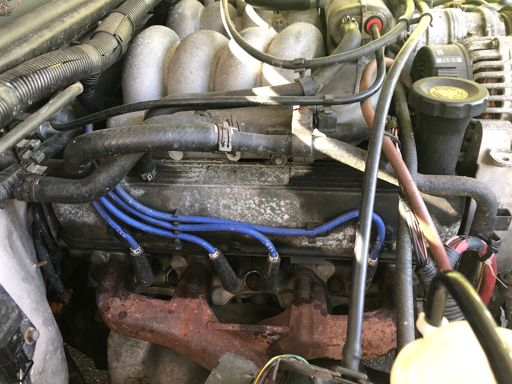

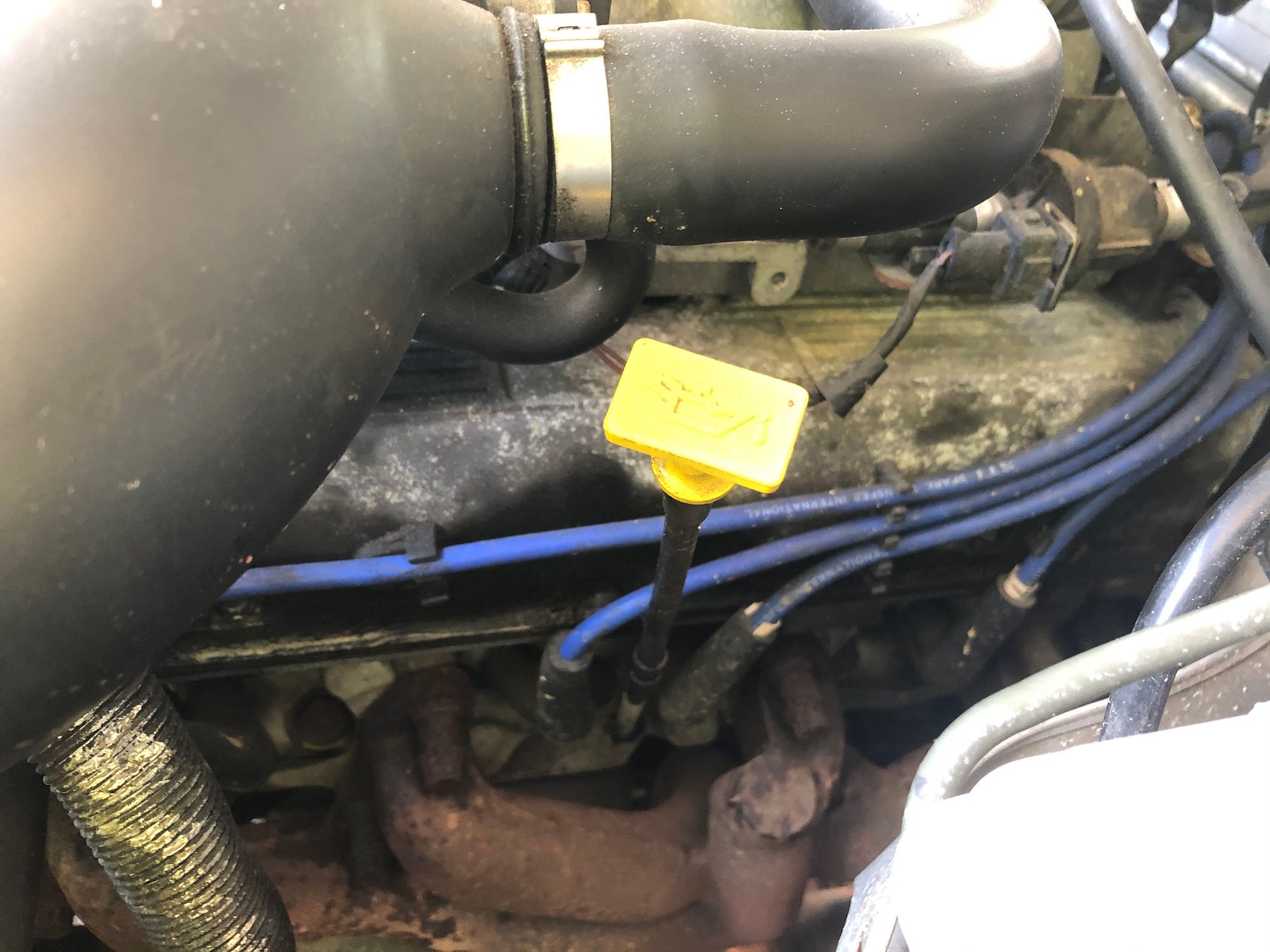

The engine still runs fine but it does leak a little coolant around the gasket on both sides. I am doing it as a preventative measure since my truck is at 200k miles. I’ve heard that a machine shop can get the heads trued for $150 so I was wondering what the $1000 on top of parts consisted of? It is for the tools? And is there anything else I should do once I have the heads off?

Old Aug 4, 2020 | 03:24 PM

That looks like valve cover oil leakage, not head gaskets.

Neither of those pics say head gaskets to me. Are you seeing a loss of coolant in the reservoir? Any misfire codes?
If you're referring to this, tha's oil leaking from your valve cover gasket. Much easier fix.

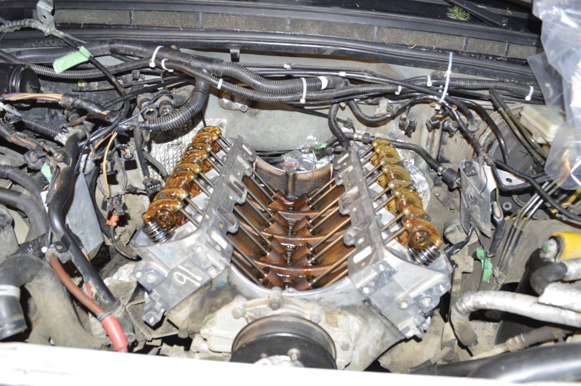

@TyTyBinks by the way do not get discouraged because we are asking a ton of questions, troubleshooting is the most difficult skill to learn. You are way head by wanting to do this yourself.
If you see coolant leaks at the rear of the engine on both sides is is most likely the valley pan gasket, it is rare for both head gaskets to fail at the same time in the same place.
The gasket we are referring to sits between the heads and on top of the push rods,see the picture below no gasket but you can see where it sits. They typically leak at the back (no I do not know why they just do).
Water flows into the heads at very front and very back, if the gasket is not installed right or the bolts get loose you will get coolant leakage there.
And because the engine is angled back a bit it tends to show as a leak out the back.
If you have access to or can rent an inspection camera with a light you can look under there to check
