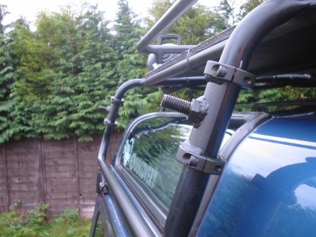

Well, Depends on whether you want the satisfaction of making them, or buying them. I have seen a few that you can buy, several of them very smart indeed, however I would probably make mine, heres a example of some made byDarren Burgess of landroverdiscovery.netin the UK. They are very simple but effective imo and completely adjustable /removable like you want.
these are probably the quickest / neatest solution I have seen, but no idea who made them, whether they are even home made or bought items. But they are VERY smart
