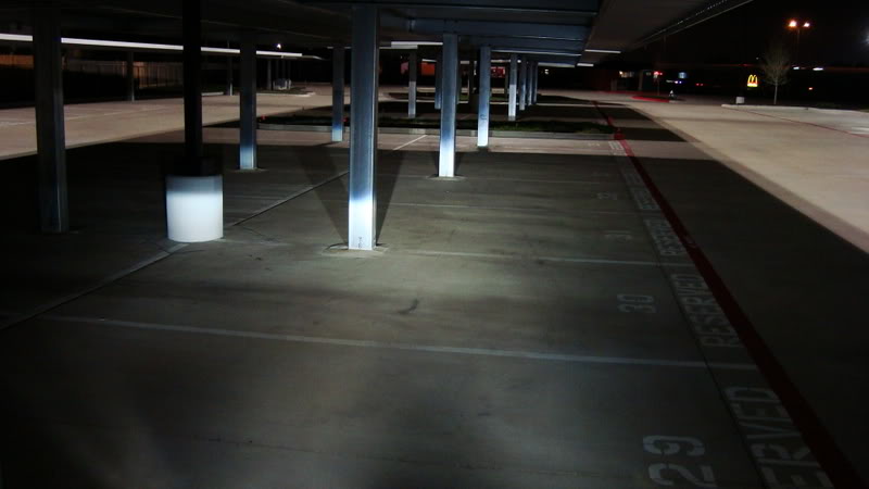

That was clearly shown, with photographs, in a thread on Land Rovers Only to not be true.
It's nearly impossible to get the proper light cut-off line with HID's stuffed in to Halogen housings. This is a proper cut-off line.
There is more to headlamp design than the reflector. Even assuming the reflector in the kits are perfect, which I doubt considering the people selling them know fitting the kits is illegal for use on public roads, the lens is just as important. Halogen housings have lenses designed for halogen bulbs, which have an entirely different arc shape than HID bulbs.
Frankly I'm amazed at the number of people who publicly encourage others to violate a .very clear NHTSA regulation.
Even with housings designed specifically for HID bulbs NHTSA published studies show that people are more affected by the glare from HID vs halogen because of the bluer part of the spectrum given off by HID. For a halogen to result in the same glare they need to be 30-50% more luminescent.
For the driver, given how the human eye is built and functions, a very logical hypothesis can be made that one actually has poorer peripheral vision with HID's because of the stark contrast in lighting, vs halogen and how our eyes adjust for nighttime vision. What one thinks they are perceiving as far as ability to see safely is often not actually the case when tested under controlled conditions.
