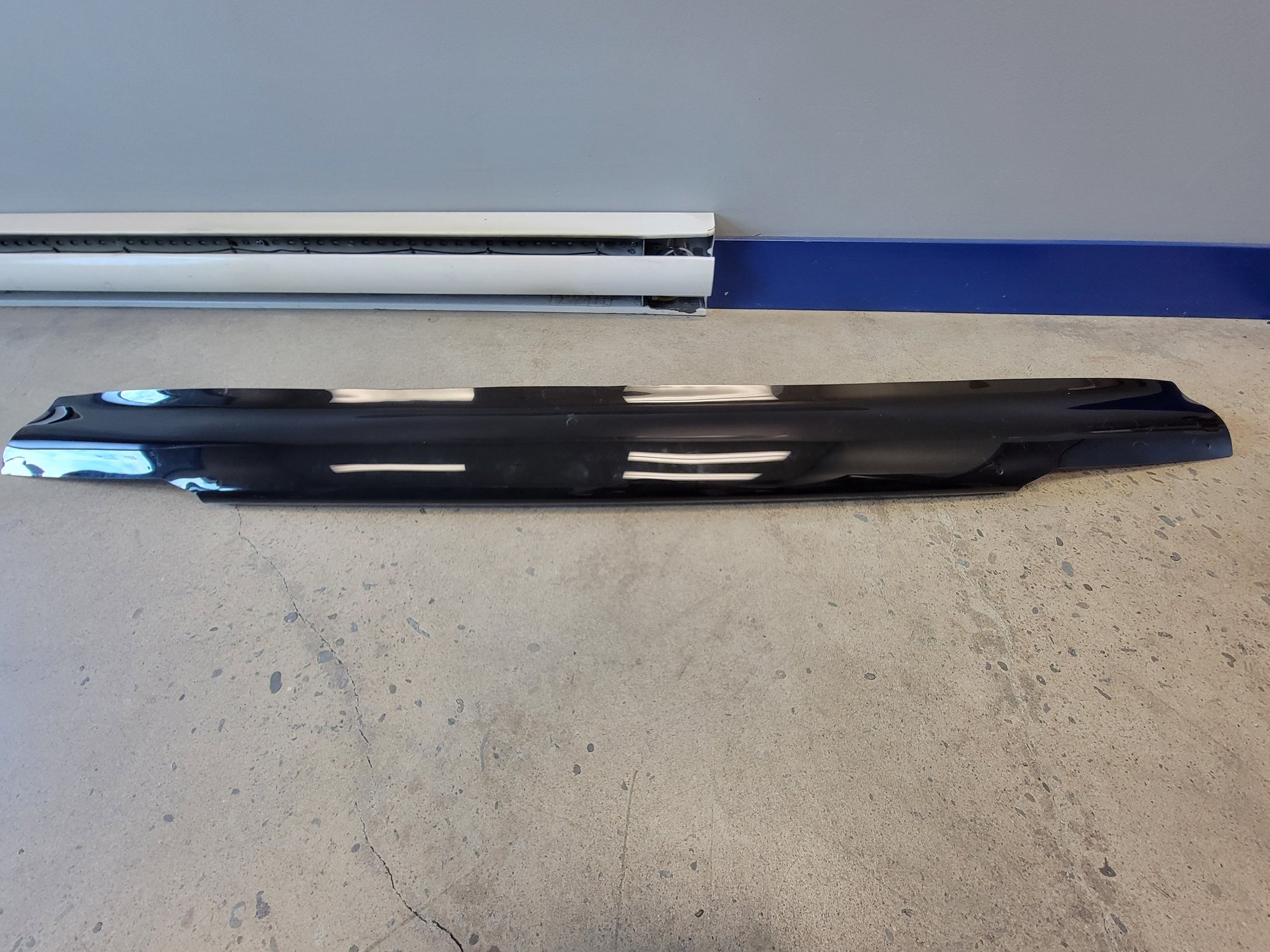

Anyway, I got my hands on one for a 98 Discovery. They don't make them for the newer models, mines an 03 D2.

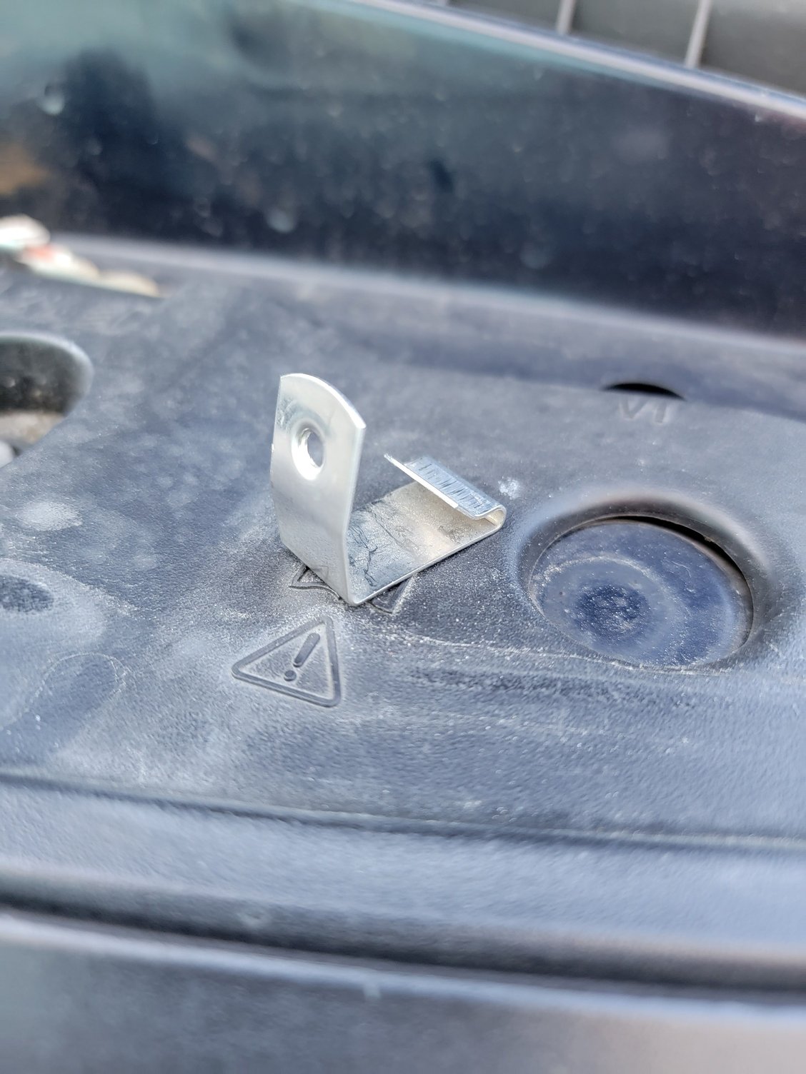

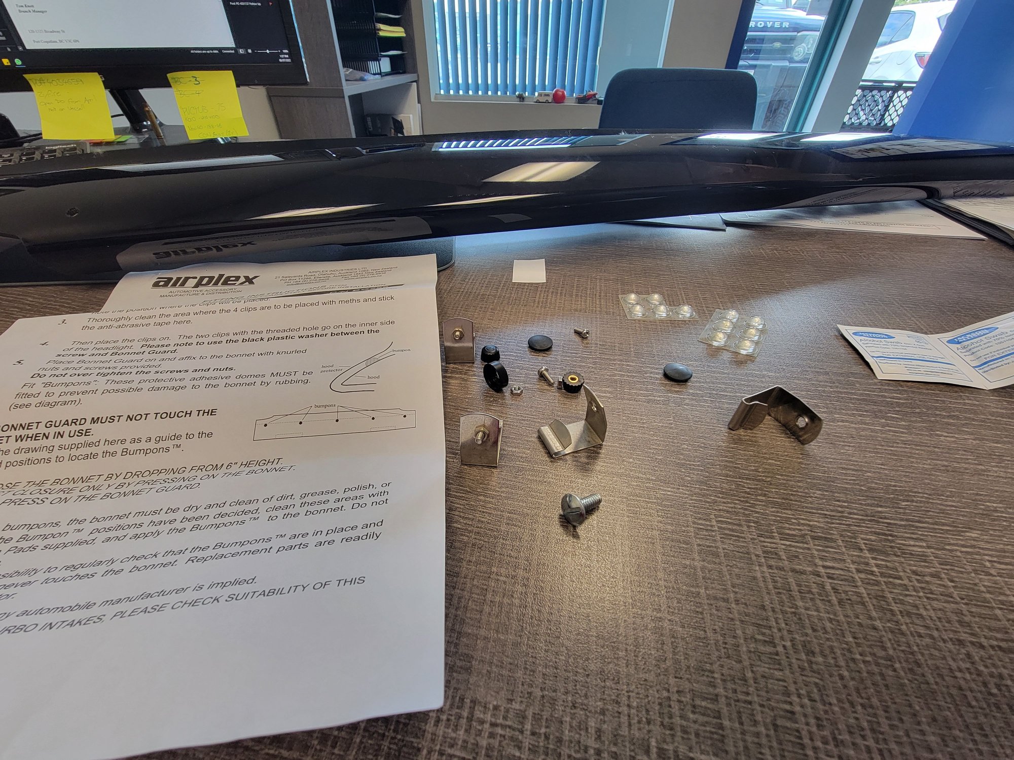

Its not made to fit this vehicle, but I've seen it done...I am stumped...before I start drilling I'm reaching out to see if anyone on here has done this and how?

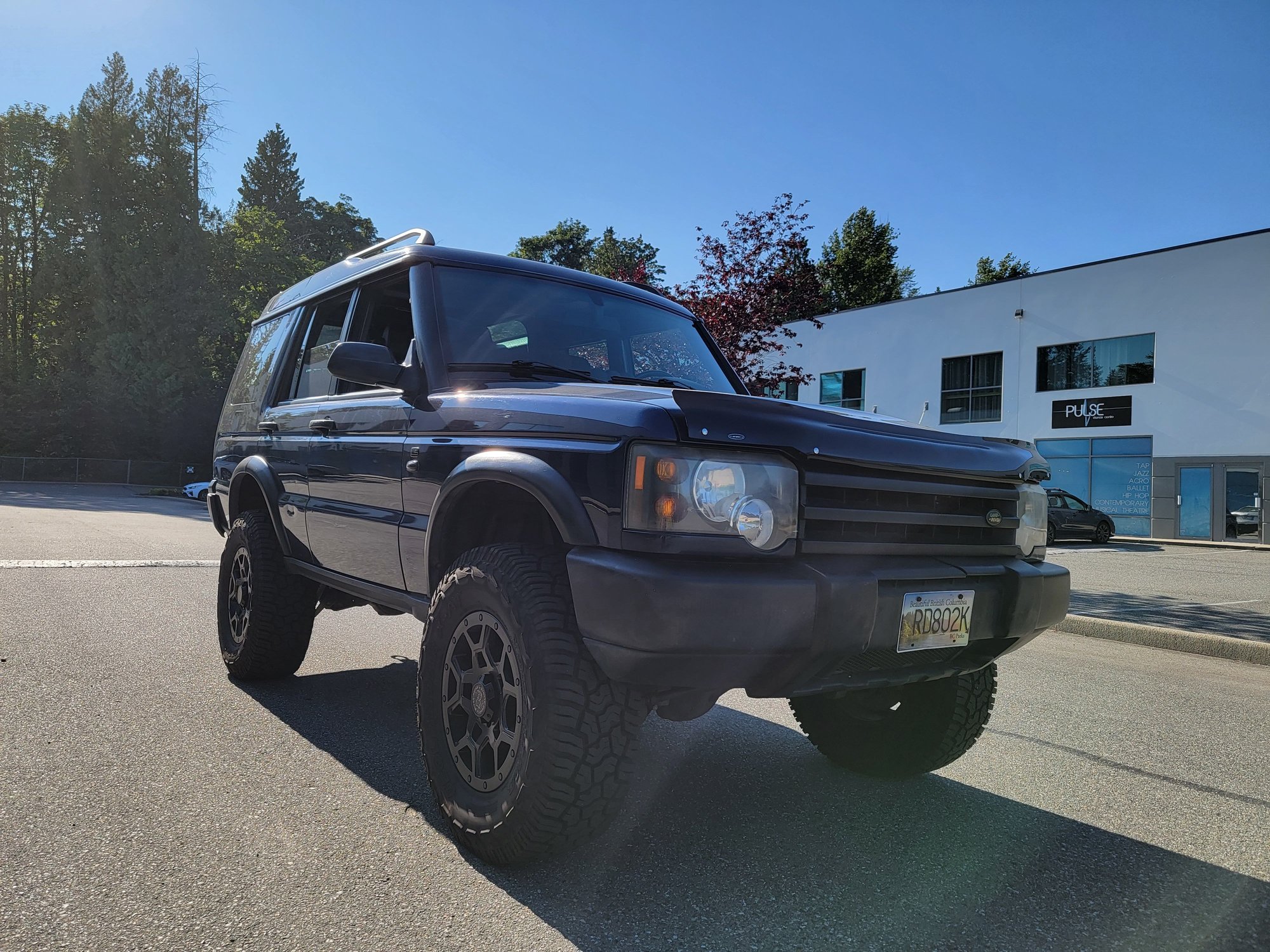

I don't know what the differences are between the hoods of a D1/D2, but the clips provided for mounting don't seem to be useable...the last pic is a random D2 with the same part installed to help motivate me!
Guard
Instructions & Bits
Clips?
Random D2

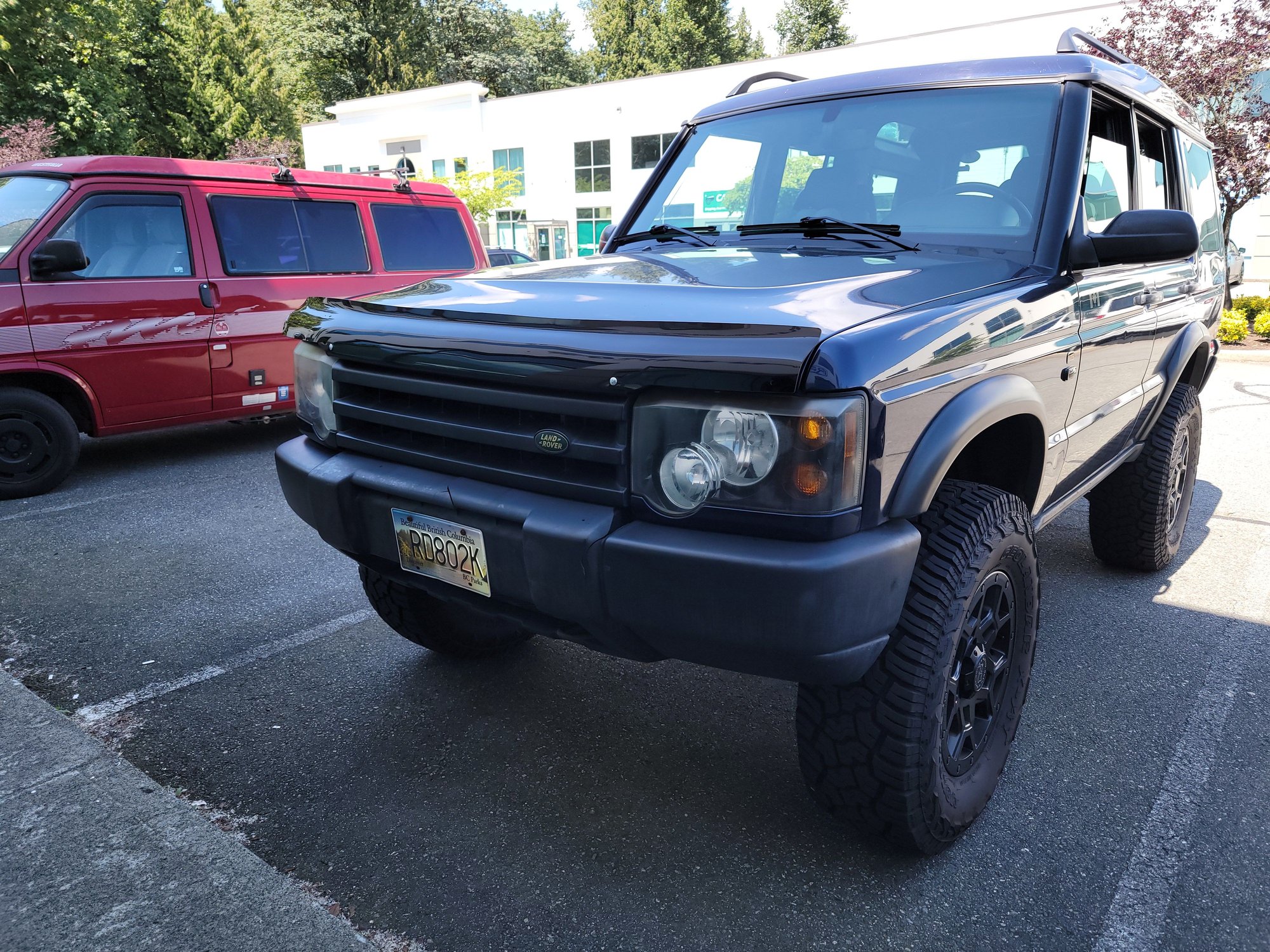

Here it is all done.
Hardware included in the kit is not used
4 holes need to be drilled through the hood
4 holes in the deflector need to be slightly enlarged
1/4 x 2.5" carriage bolt, washer and nyloc nut
3/8 ID PVC pipe cut about an inch long used as a spacer between the deflector & hood.
About $3 worth of bits from Home Depot & that's it.
I can't tell you where to drill, everyone will be different depending on how they measure it up etc..
