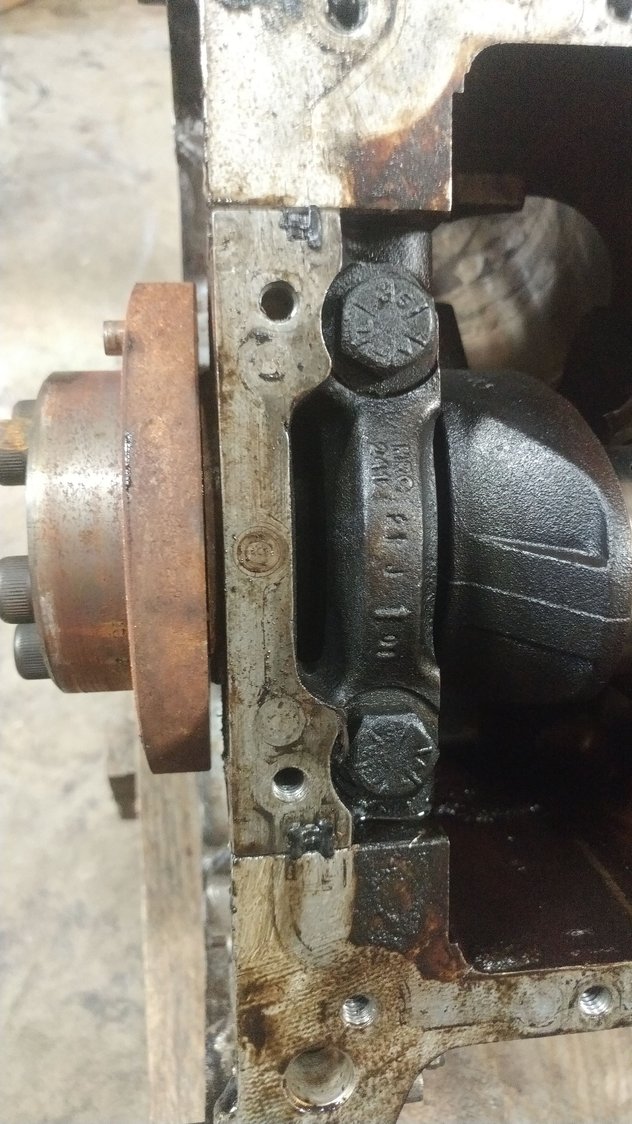

How many miles? Leaking rear main seal? Usually it is the crucifix seals, you can replace them with the pan off - no more rear oil leak.

Oh cool! So I should replace the crucifix seals while I have the pan down? They're pretty easy to access with the pan off?

4 more bolts to get the rear cap off, then you can replace the crucifix seals. The Rover v8 has an interesting rear seal design that means the rear seal almost never leaks, but the crucifix seals can. Most rear seals are under pressure from bearing leakage from the main bearing, however the Rover v8 has a void between the rear seal and the rear main. They put a drain slot in the rear cap in that void, so the oil drains back in to the pan. However the side crucifix seals are under pressure and can leak, some were known to be installed incorrectly at the factory. Can't change the rear seal, but the crucifix seals are easy. Two main cap bolts, two side bolts.

You sir are a gentleman and a scholar. Thanks for posting those photos. I'll order those crucifix seals right now. Are these they? https://www.roverparts.com/Parts/LUN000010 They look different than what's in the photos.
Anything else I should know about their replacement? What are they referred to as in RAVE?
