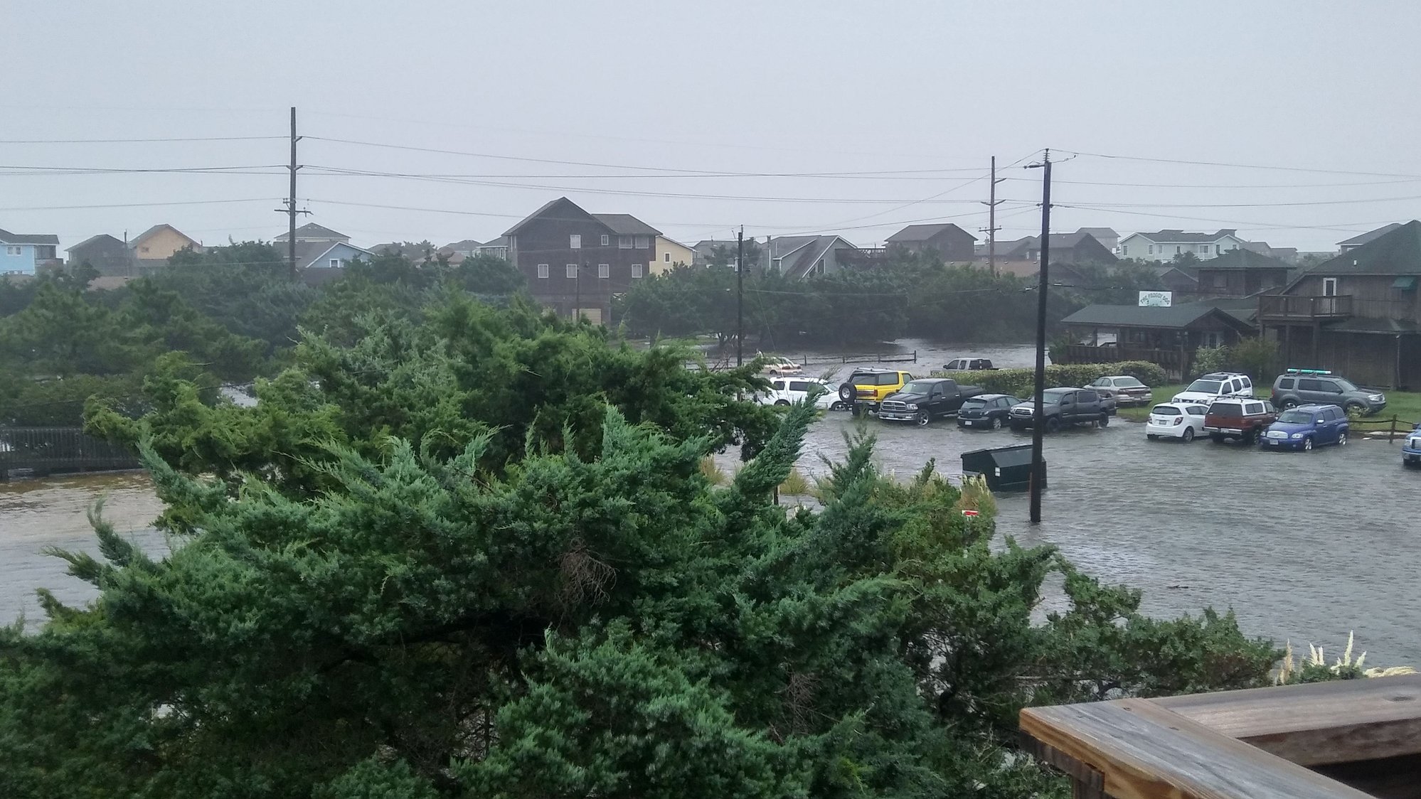

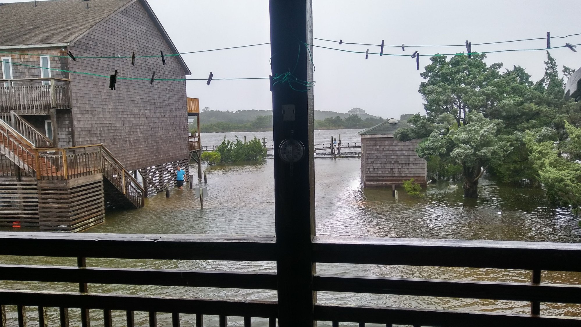

Yeah 12 was totally flooded. I disconnected the battery this morning and went fishing for a few hours. Came back reconnected the battery and attempted to start the truck and it cranks but doesn't start. I tried and tried but no start. Finally it turns over and runs good. Amigos still on ( I know they're not a big issue) I'll start it again in the morning. The carpet never got wet, and it definitely didn't get up to the edu or the bcm under the dash. I'm sure the o2s got wet, even with a respectable bow wave. Want more pics? See how the majestic sound flows into our parking lot.
Bonito rd by Tarpin ln. That feild was under water
The water line didnt get much higher when i stopped for 15-20 mins.
Rt 12 at Tarpin was waist deep with salt water. Its not rain.
