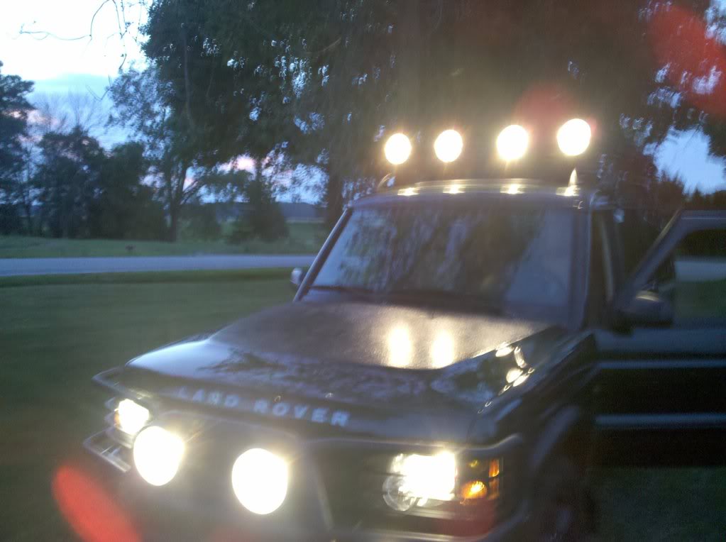

i just got finished blacking out my hood with hurculiner!!!
it looks great and was easy, heres a 10 step write up.
you will need:
-hurculiner $29.99
-professional auto tape
-paint roller and tray
-100 grit foam sanding block
-wax and grease remove
-cotton towels and 1 tack rag
to apply:
  1. wash the hood
  2. dry off the hood with a sham
  3. remove wax and grease with a w&g remover
  4. tape off hood
  5. sand hood up with 100 grit sanding block
  6. wipe off dust and wash the hood again..leave tape on
  7. dry hood again with sham
  8. remove wax and grease with a w&g remover
  9. roll on hurculiner,even 2 coats
  10. wait 3 minutes and remove tape and let dry for 9 hours
use quality automotive masking tape, and take your time....i did this in under 30 minutes...dont skip any steps..

Looking forward to the pics
Old Jul 12, 2010 | 08:43 PM
03discoman's Avatar
Joined: Apr 2009
Posts: 561
From: Port Huron, MI
pics are up...sorry bout the quality...all i have is my cell phone and its dark out...
i dont think the bed liner keeps the glare off the hood as good as flat black paint...but bed liner hides everything and its more durable...i like it alot and i'm going to do my roof next.....
the area above the windscreen has some rust spots under the paint......this would be perfect...

I like it! I wonder if you could add a dulling agent to the Hurculiner so it would come out matte. All the bed liners I have seen have been dull. Maybe it it is available from an automotive paint shop.

just re-tape and roll on a flat paint after the liner is dry.....KISS

Does it dry more like hard plastic or rubber? I have wanted to spray bed liner on my wheel well arches for a while. I saw a post linked on this forum from a guy with a dark green D1 who did his wheel wells and lower doors. It looks really cool.
It will dull over time with just a little wear. Mine was shiny everywhere except where sunhit it or my feet or a mat came in contact with it.
I would do it to my disco if the carpet was in worse condition. Im considering doing it to the cargo area..
Old Jul 12, 2010 | 11:50 PM
Spencerfitch's Avatar
Joined: Apr 2010
Posts: 1,482
Likes: 8
From: Gramercy, La
Id say its more of a rubber..
Watch out for one thing.. Hurculiner has inconsistancys, sometimes is ruff and sometimes its smoother [his photos]. This is from can to can..
One way to fix this is filter out the rubber graduals [duraback smooth] or add a little back in depending on your prefrence. You can also buy them separate incase you want more..
For a free sample on colors, go to the duraback website. Its the same as hurculiner but they have a duraback and duraback smooth. Comes in MANY different colors.
As for doing the lower doors. Id say go for it.. Id go with the hurculiner 1000x before I go with a rattle can bed liner..
I did the rattle can bed liner on my 4runner and it looks great, BUT..
Rolling on is SO MUCH EASIER.. ANYBODY CAN DO IT.
