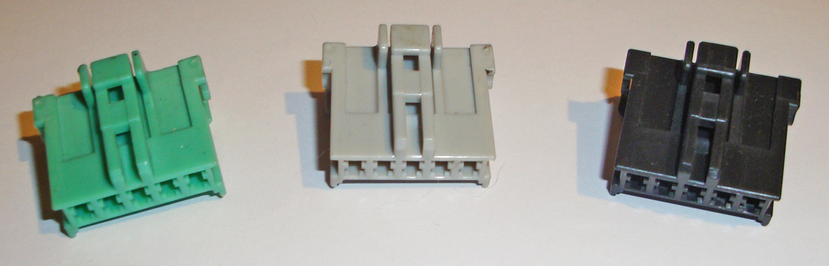

Originally Posted by longtallsally
Can I revive an ancient thread? Are the plugs for S12 and S13 available anywhere?
Or more importantly, are those specific plugs used anywhere else of the vehicle? I have a parts truck and could use one there.
My use is an oil pressure gauge that I need constant and switched hot, and I don’t really want to use a tap or run all the way to the bay..
Help?
I still have the S12 and S13 socket connectors, if anyone wants to order them (PM me on here), or email = lr_connectors@btinternet.com
You're correct, in that the windscreen wiper motor connector (Grey) on the D2's harness is the same connector that fits the S12 socket
The same Grey connector can be found in some Rover cars - I don't think that you had them in the US (you didn't miss much )
The connector can also be found in some Japanese cars, especially Hondas, where it's usually in Light Green -
I don't know what car the Black version comes from.
I also don't know what cars the S13 socket connector can be found on - but, if you're searching through junk yards, I would concentrate on the Japanese cars.
