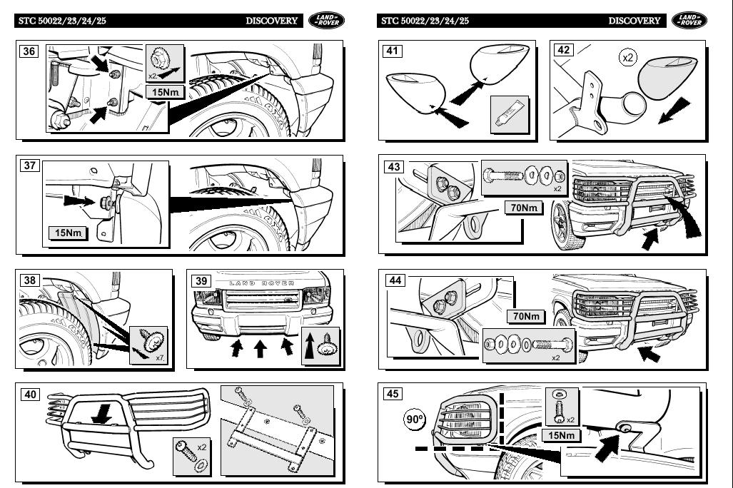

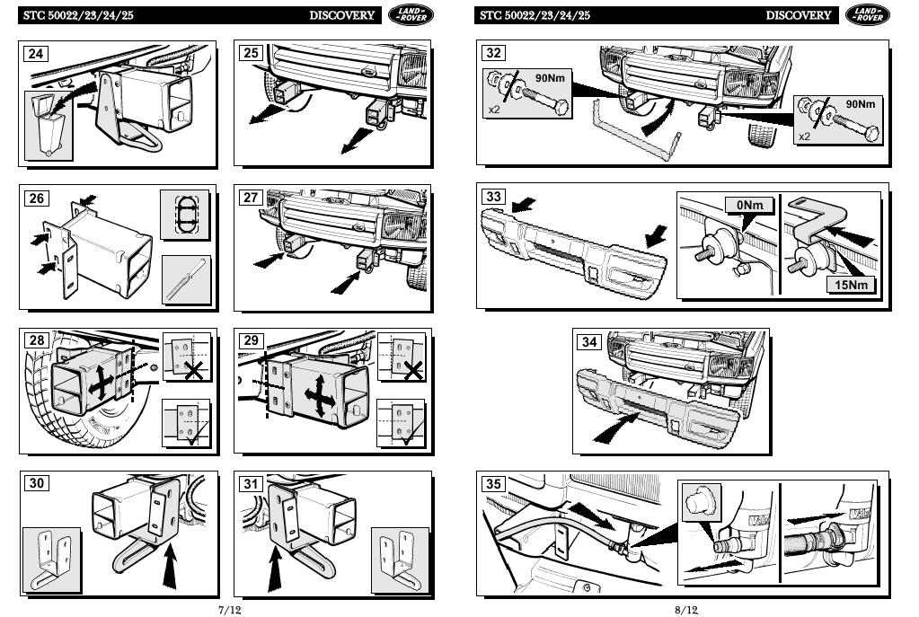

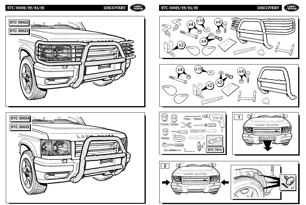

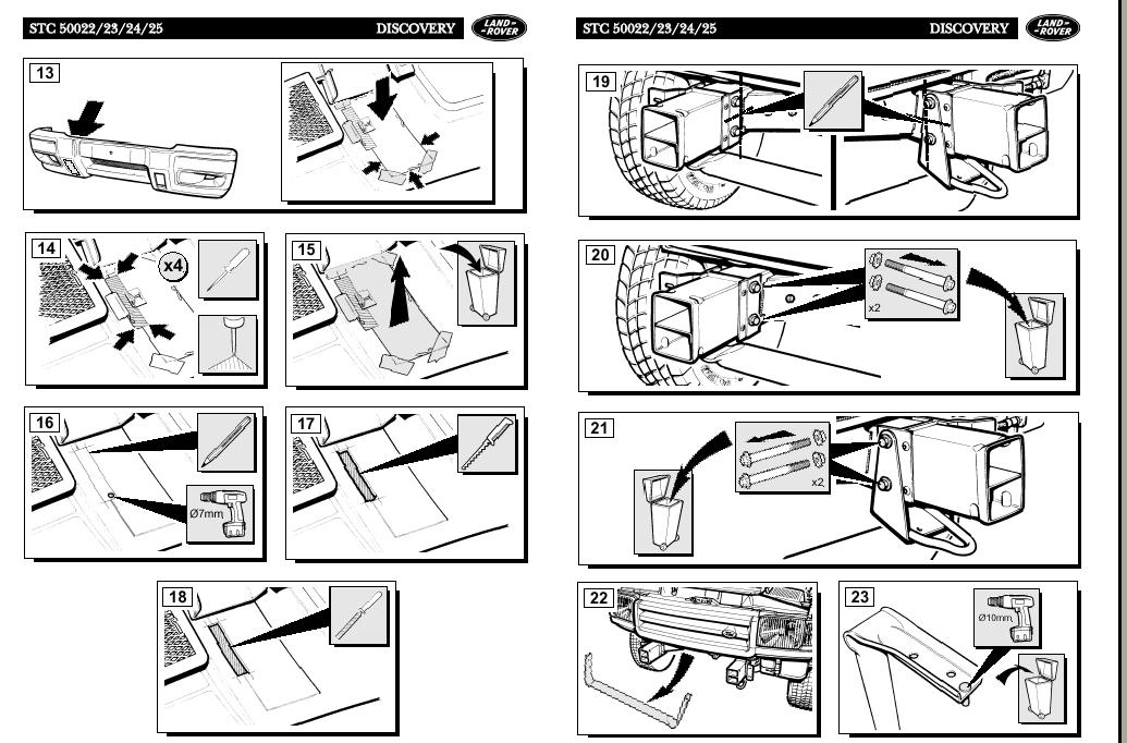

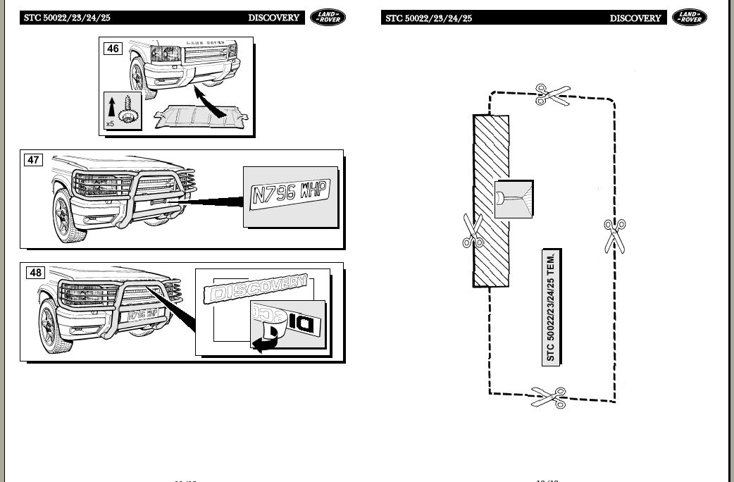

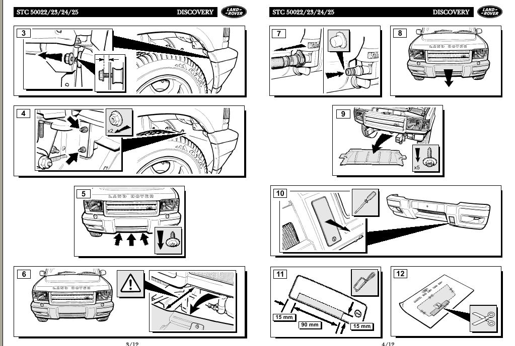

Thanks for all the input! I have already checked out those instructions on roverparts.com and I understand that part I just can't seem to find anything on how to get to those chassis leg brackets without cutting. If you are looking at the front of my rover, the right recovery hook seems to be attached to the chassis legand has a snap out opening, the left however is under the panel below the bumper. I have no problem cutting the bumper I just want to make sure that I do it right. I would appreciate it if disco2guy would send me the pages referencing the bumper attachments and such from the rave cd ifhe doesn't mind emailing them to me at jsmith23@covhlth.com. (I haven't been able to download it right so I will probably get the cd off of ebay.) I am planning on doing the install this weekend and I think I will take some pics to post because I haven't been able to find anything helpfull on the net yet. Thanks again!!!

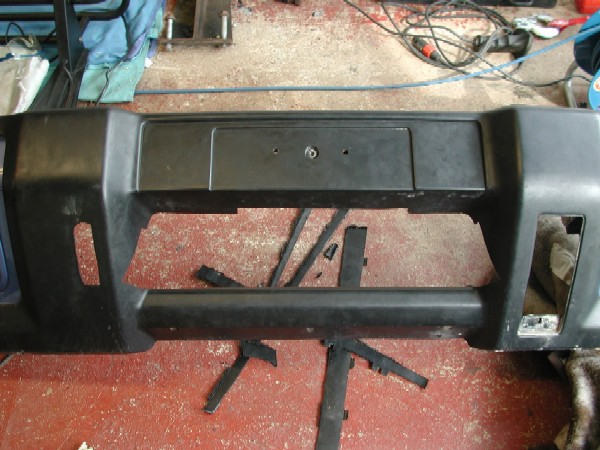

You have to cut the Tow hitch plate on 1 side, and then match up a hole for the opposite side to allow the bullbar to go through the bumper to the brackets.
heres the genuine instructions for you If you need a close up photo, just shout and ill take a few of mine.
EDIT, just found a photo on my winch install thats relevant, here you can see the "cut/ hole" that is opposite to the tow hitch cover to give you an idea

That is perfect!!!! I swear I feel like I could pay this site a couple hundred a month for its services and still be coming out cheaper than without it!! Thanks again for everybody's help and I will post some pics when I am done.
