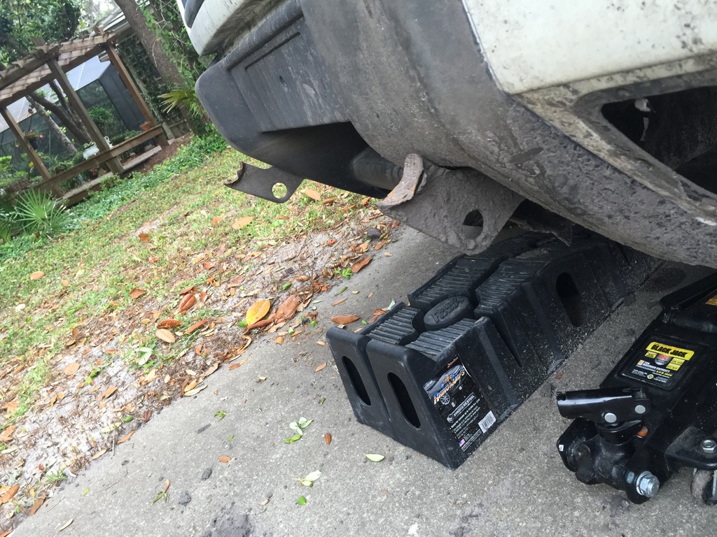

The brush guard bolts directly to the frame and has two eye lets to put shackles through directly in front of the frame connection points. Which ARE recovery points, unfortunately my shackles were to damn big to fit through the holes because the base of the brush guard was in the was. So I strapped around the guard itself, I didn't have high hopes for it holding, but once it was snapped off, I was then able to get my shackle in the eye let on the piece of the brush guard still connected to the frame. That's ultimately the connection spot that got me out! If you have a brush guard and need to use the recovery points on it, make sure you have shackles that fit!!

Here's a picture of the recover points on the bottom of the brush guard:

Good to know! I have shackles to fit those holes, but when I used them to tow the truck home when I was having fuel pump issues, the brush guard would move back almost against the hood. seems to be moving on the bolts to the frame even after I tightened the crap out of them with a long bar. It still moves a bit...
Thanks for the picture!! Maybe I might add some gussets to strengthen that point a bit.

I know exactly what you mean. When I added a LED bar to the brush guard I added a horizontal support bar from the light mount point to the inside of the grill. That was the only thing that helped stabilize it from shaking (and was my wire run) no matter how hard I tightened down the Frame Bolts. But regardless, if you have a brush guard and need to use it as a recovery point, those bolts holding it on going through the frame, leading to the eye lets are super strong. Obviously, the welds holding the brush guard to the connection points are weak and the guard itself should not be used as a pull/recovery option unless you want to snap it off like a match stick like mine did!
