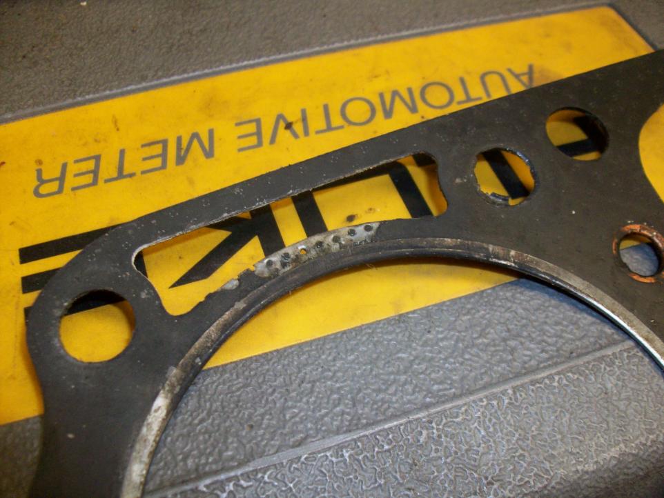

I have to agree with jfall on this one.
#7 has an incredibly small amount of gasket between
the cylinder and the large water jacket opening.
And who says the HG job was done correct, heads resurfaced, new bolts used, you can't know in most cases.
I am by no means a LR expert, but been there done that.
See attachment, that lil bit of missing gasket caused nightmares.
The sauna sound under the dash is soothing to the brain, but your wallet will not like it.
Edit in this thought. The lower head bolt on #7 is the hardest to get to during an engine in the vehicle HG job.
