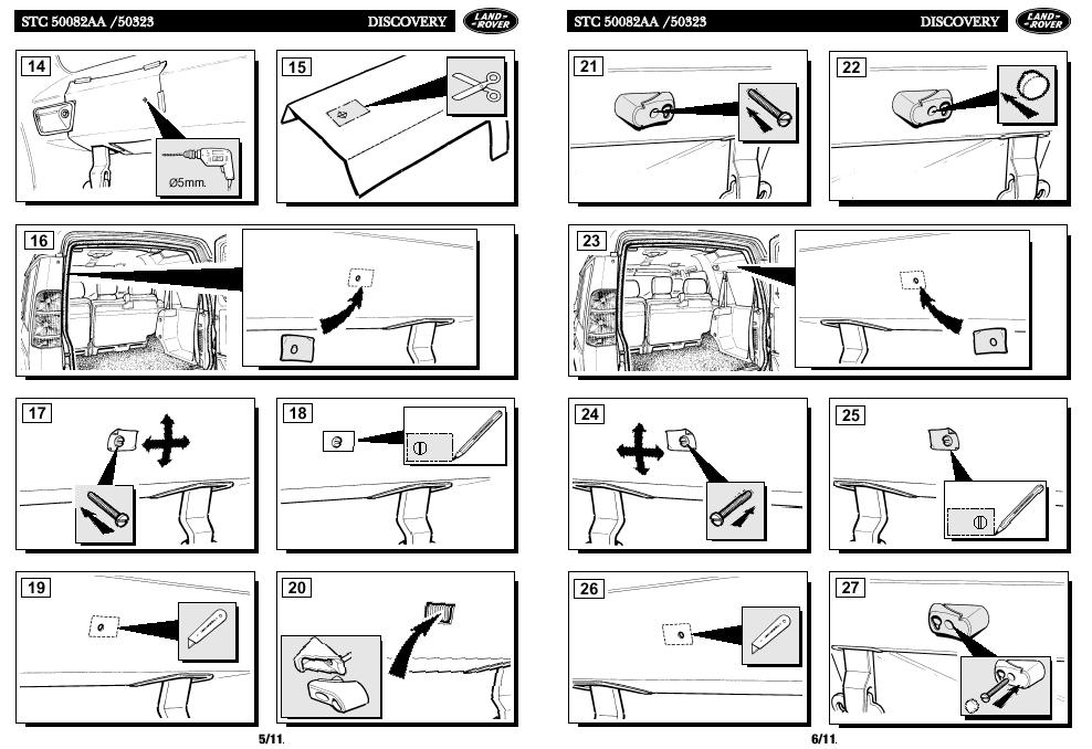

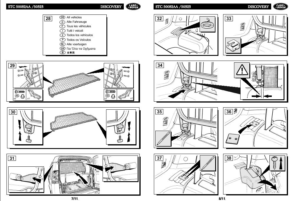

Well I have webspace, so here you go
You dont need step 11 really , all it is is bolting the jump seat back in.

No I have not done it, But have one in mine,and it would be simple to do, The instructions take note of vehicles with out 7 seats because they have no rear handles, If you have seven seats its even easier and you dont need the template as it lines up with the handle fixings at the top. So you do that first, fit the dog guard brackets to the dog guard, clip it in the top fixings, Hold it square / vertical and then using masking tape just mark where the bottom fixings go.
You then simply remove the rear Audio panels (if you have them) drill through and fit the lower brackets, backing plates and nuts, then refit panels and clip the dog guard in place. I would think it could be done in an hour or less.

Best bet to print instructions I posted is to right click each image and save each image to your pc and print them from there.
