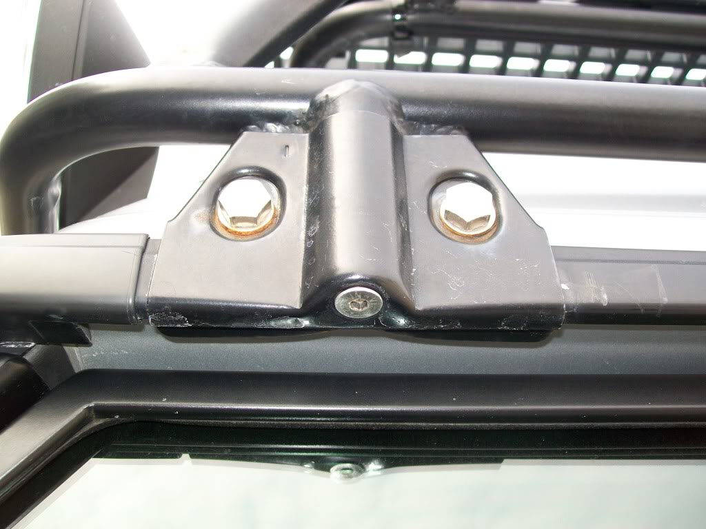

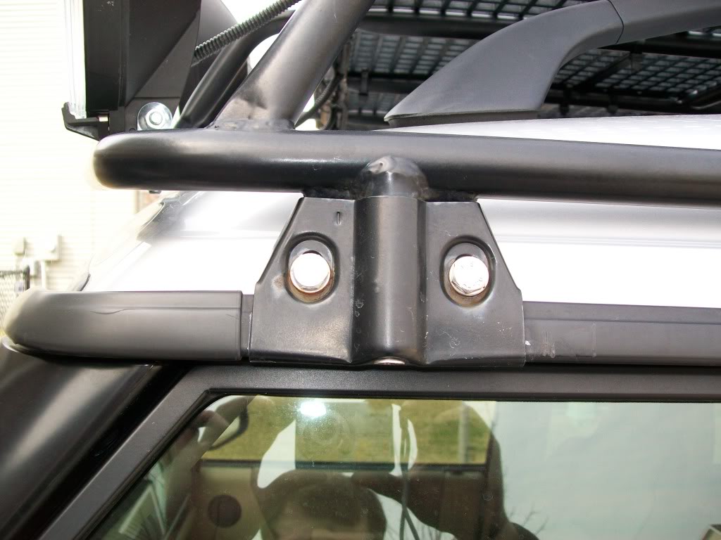

OK - I am an idiot... I just went outside and looked and mine has 3 bolts as well on each mount. 2 of them are 13mm and one is the allen from the bottom.
I took 2 pictures so you can see how mine are mounted. Also, I think that the rack is wider in the back then in the front so you might have a hard time mounting it if you have it sitting too far back on the truck. In the second picture below you can see how close to the front of the truck mine is mounted.
Also, I remember that I got all 3 of the bolts started, then I tighten the allen first and the 13mm bolts second.

I wonder if the PO may have bent the tabs a little. I didn't want to use the drill to make the allen screws work. Thank you rj95lss for the pics. I will have to do some measurements and see if I can get it to work.
