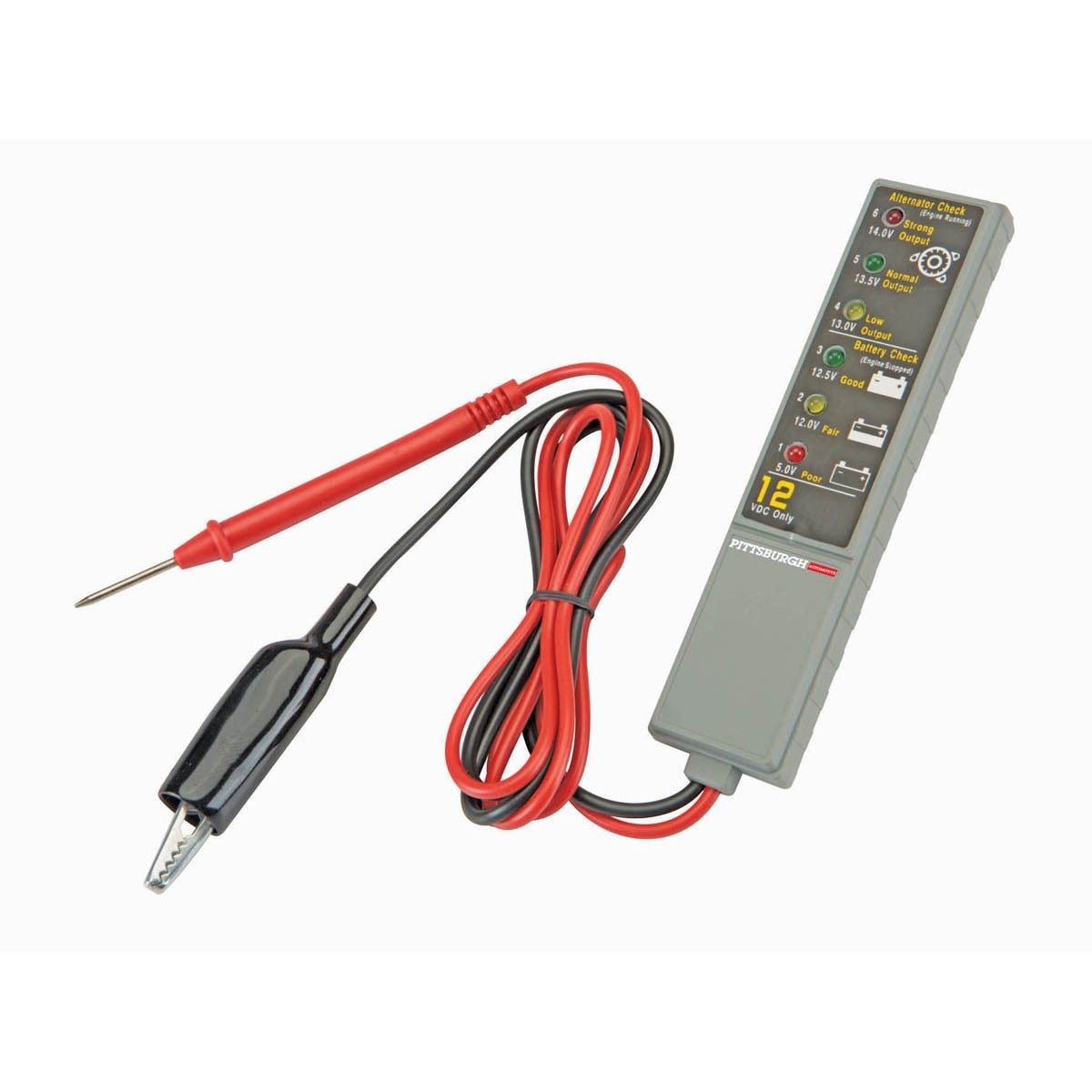

I would check and clean all ground wires, battery posts first. Check the belt to see if it is hard and cracking. I would also go to Harbor Freight(if you have one near) and purchase this little gadget for 4.99. It can be used to check voltage, alternator, and i use it to check fuses.

i just saw that at harbor freight last night
