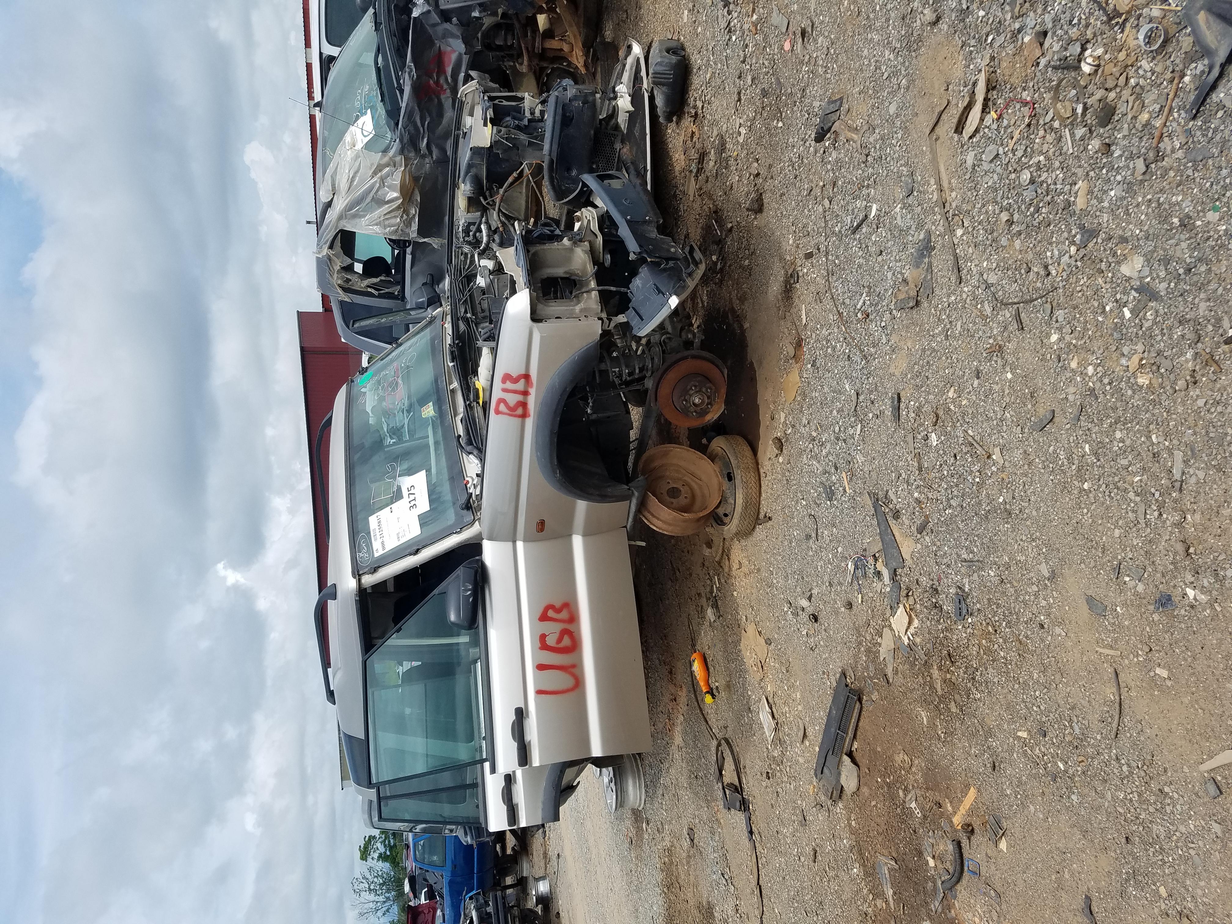

03 SD
so no factory trailer hitch, or harness...or sunroofs or leather.
Nice dash, switches, etc
I think theres a black 04 somewhere too, so I'll be here for a little while longer.

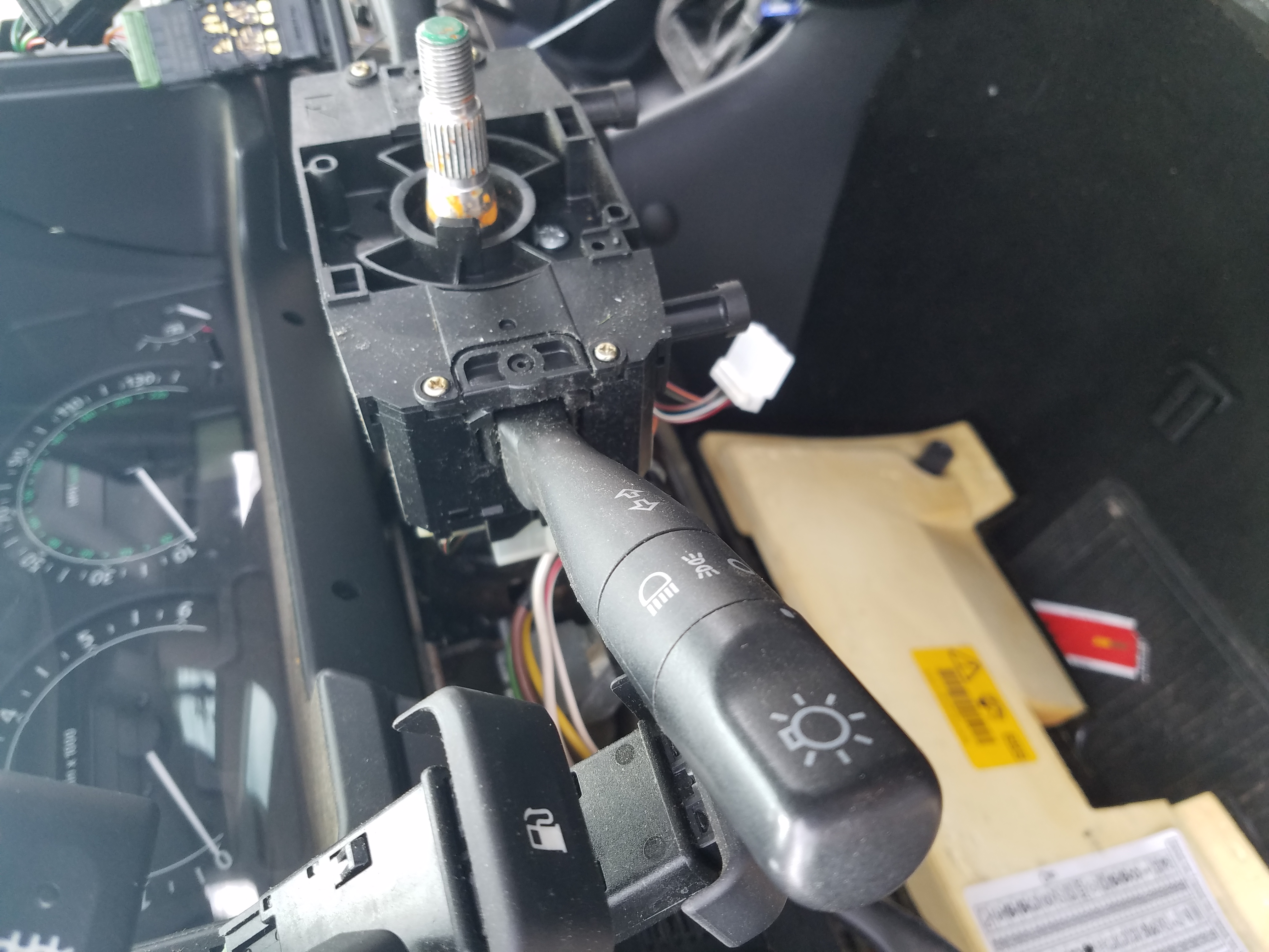

You want the whole stalk/switch assembly??

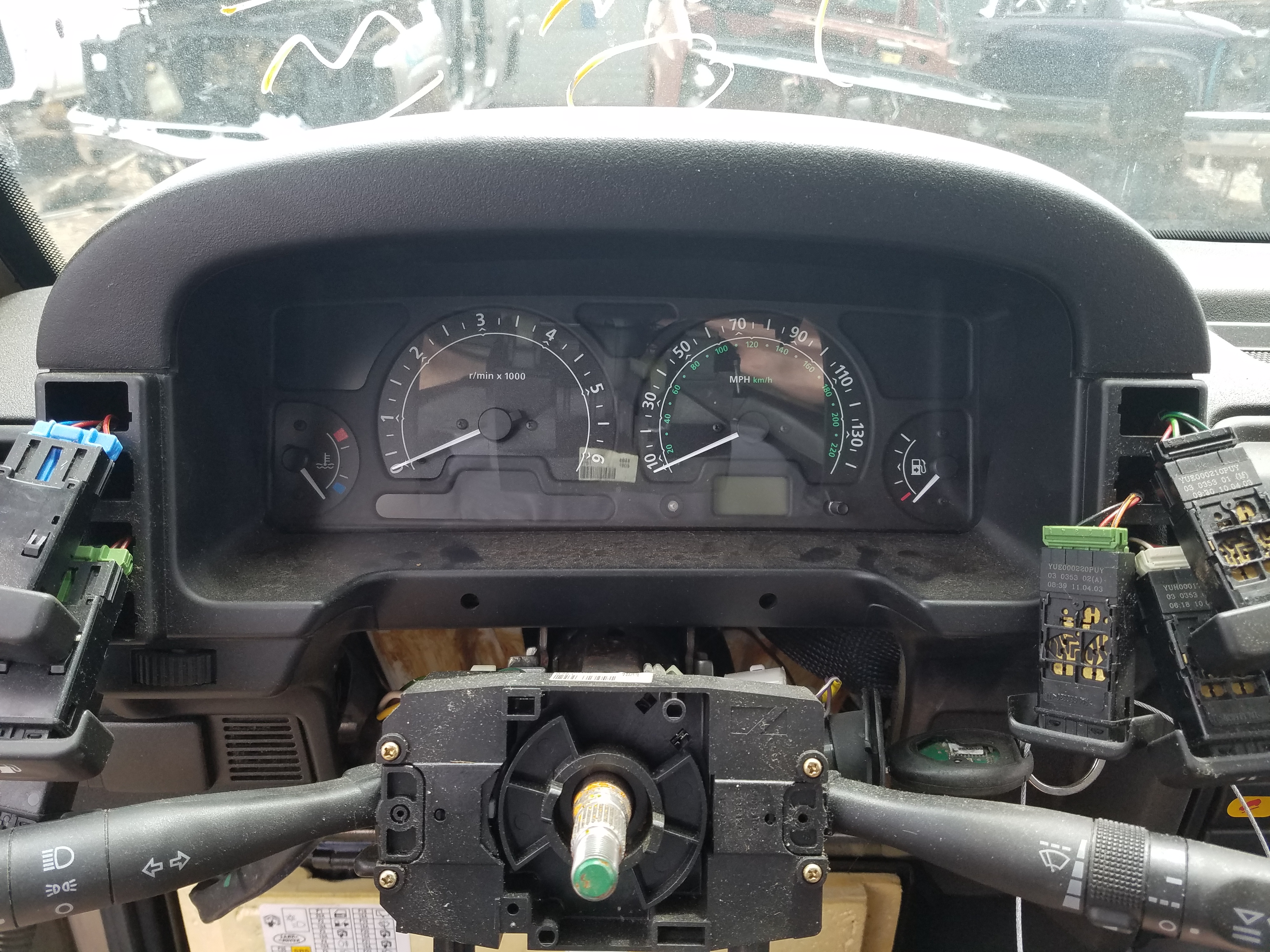

How is the black gauge cluster bezel in that first pic? Is it un-damaged? I don't need the switches just the bezel for a friends D2.

Looks good
How does it come out without breaking anything?

bottom screws are really all that hold then you pull it up so the rear tabs release if they're still intact. They usually bust all below the gauges where the two screw holes are.

Just unplug the dimmer wire connector, remove all switches, then pull up and back and it should come off.
