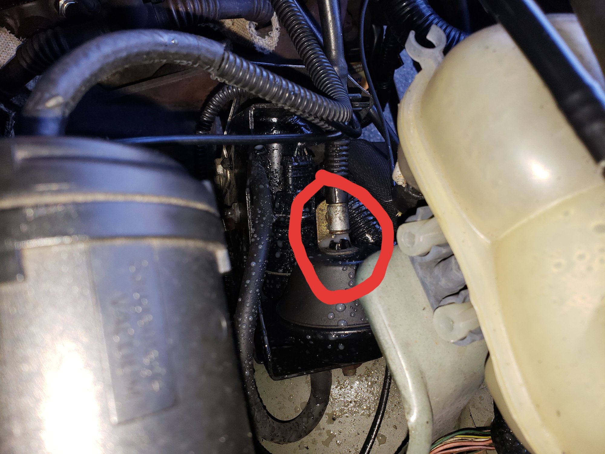

So I have just fixed my missfires and other issues.. Its run fine twice for a total of 15miles and then I'm driving along just now and suddenly lose power and start hearing a weird poppoing/clacking sound. Smoke starts filling the cab so I stop and the engine dies. I jumped out praying that its finally on fire and going to burn down!
No such luck so now I see smoke coming from valve cover area and see oil seeping onto the manifolds.. So that's not the problem and I can tighten that up.
I did notice coolant all over the passenger side of the engine bay in the back area. I noticed that this one piece may have separated somehow and causing it to spew.Ive circled the suspect spot and added my engine codes indicating catalyst issue. Could these to be related or is the catalyst the CATs underneath?

Engjne coolant is biege from having some stop leak in it, nd if you zoom in, its all over that back corner..
This looks like the source.. can i bypas it?
Up close these look separated..

The piece you have circled is the cruise control. It looks like the small hose coming out of the reservoir (bottom) is not slid all the way inside the hose.

Ok I found the spewing was a ruptured hose under the coolant tank. I see that the thing I was looking at was a vacuum design for cruise control.
