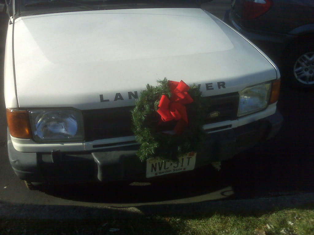

Also, the Disco is ready for Christmas

nice! reminded me to wreath up my rig
