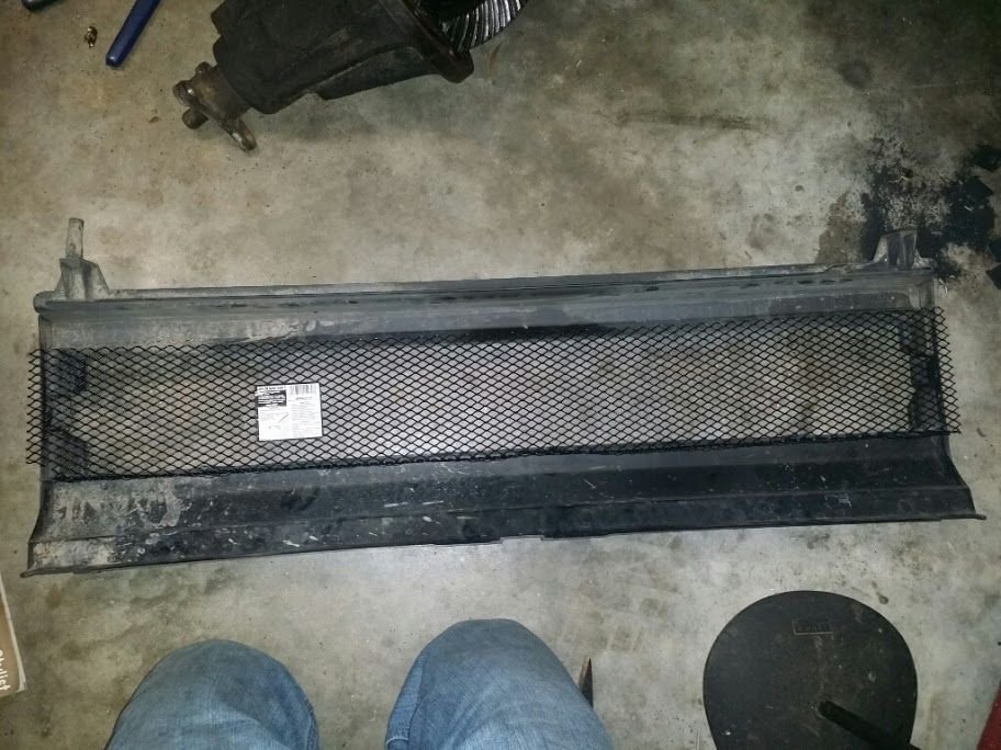

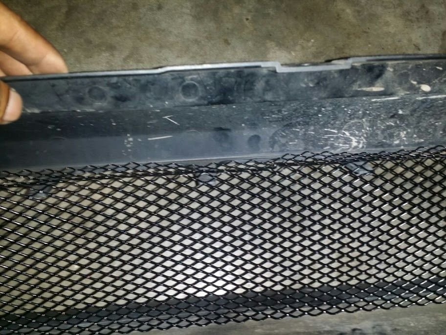

Well i started to hack away at my grille
Some bending and cutting.
And this is what i have so far, im going to fill in and sand the left and right sides with sandable putty to get a uniform look.

now you have a saudi grill, what is that with a drive shaft and a donlop on it in the back ground?

That's the second rear diff that i blew up and an extra front end setup for my wife's 06 zx6r.

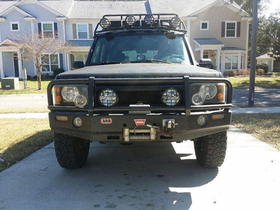

Not too bad if i do say so myself.
Her bike is 636 btw.
Funny thing i was looking at this last week WideFlow Powder-Coated Semi-Gloss Black Hi-Flow? - Hood Louvers | RunCool | Hood Vents For Your Vehicle -
