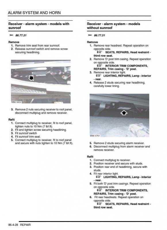

I believe I have a bad RF Receiver, I know it is above the headliner.
my 2000 Disco SD does not have a sun roof; do I need to remove the entire headliner to access the RF Receiver?
anyone have a link to the part?
doc

I know it sounds like a total beast removing the headliner, but it usually takes only about an hour at most. It's pretty straightforward, just voluminous with all the clips and trim bits.

Actually, looks like you can just remove the D-pillar trim and sort of bend it down to access it. It's located behind the passenger-side rear seat net/basket thing. Take a look...
