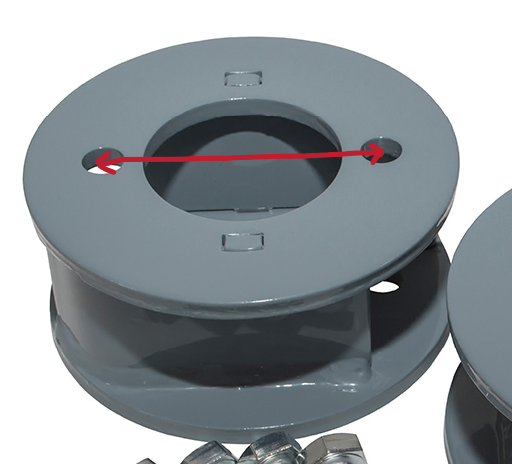

Hello there I'm new member in here, I just wanted to ask you if you could tell me about those dimenssions.
I'm lifting my td5 4" and I want to make plates at my friends CNC's, because to order in ebay or amazon there is no delivery to my country Kosovo and so on.
If anybody can tell me those dimenssions I'm greatful to you.
Old Jan 15, 2025 | 06:29 AM
Cacaj's Avatar
Joined: Jan 2025
Got it, holes from center to center as marked in photo are 7cm, and diameter of upper and lower plates are 10cm, just in case if anyone was curious to know.
Plate must be at least 4mm if you plan on doing it.
