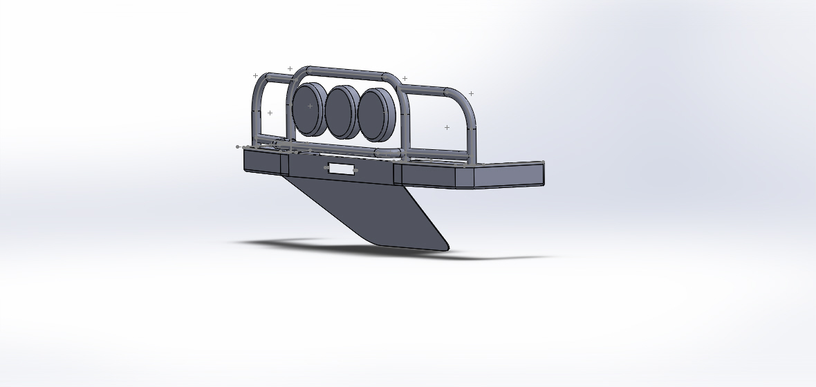

I have my steel in my dads shop waiting for a bumper build... around 200$ in steel at a low price per pound, I had to buy 20' pieces though, so I'll be doing front and rear at the same time. I'm going to use:
2x4" 3/16" Rectangle Stock (wanted a slim-ish bumper)
1.5" .120 round tubing (Bull Bar)
3/16x4" flat bar (winch tray/mounting tabs)
3/16" sheet of Aluminum (Steering/Brush Guard)
All of that's just sitting on the metal rack, mocking me. Although I should start (and hopefully finish) the front this weekend though. I have some pictures of the drawings I did, I'll post to give you an idea of what I'm in for.
Dane.

Its kind've like the Safari Guard except the base more rectangular instead of it tapering. The fake brush guard and lights are just to show what the end result will look like, there will be tabs coming from the bar in front that the lights will bolt to. I like it

I like that one Dane. Do you have plans for it? I found a picture of one on the net that looks like I can probably build without too much trouble. If it is your's nice and hope you do not mind me using your picture in this post. Couple of things I would change but looks pretty straight forward.

I do have the plans, but I'm not 100% sure that they'll be accurate
I can explain to you what it is in detail and you'd cut the pieces to fit, you could get 1 piece of 12' 2x4 wood and make a mockup. I think the bull bar and skid plate make it look good.
