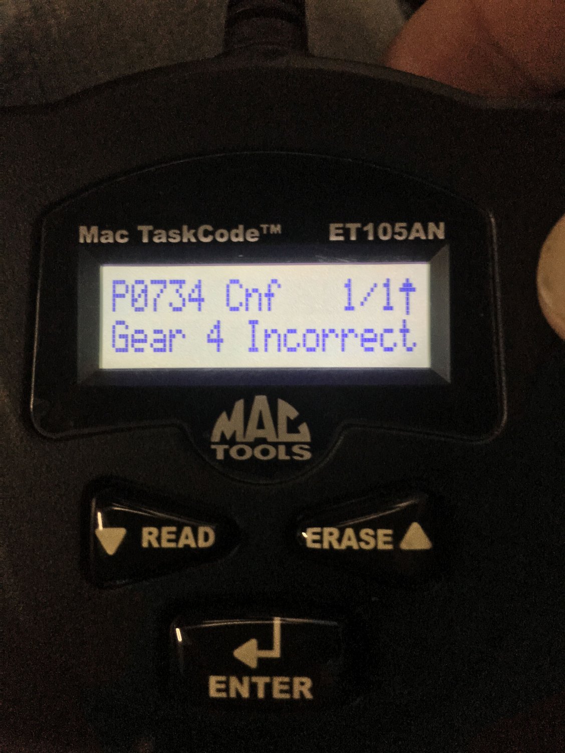

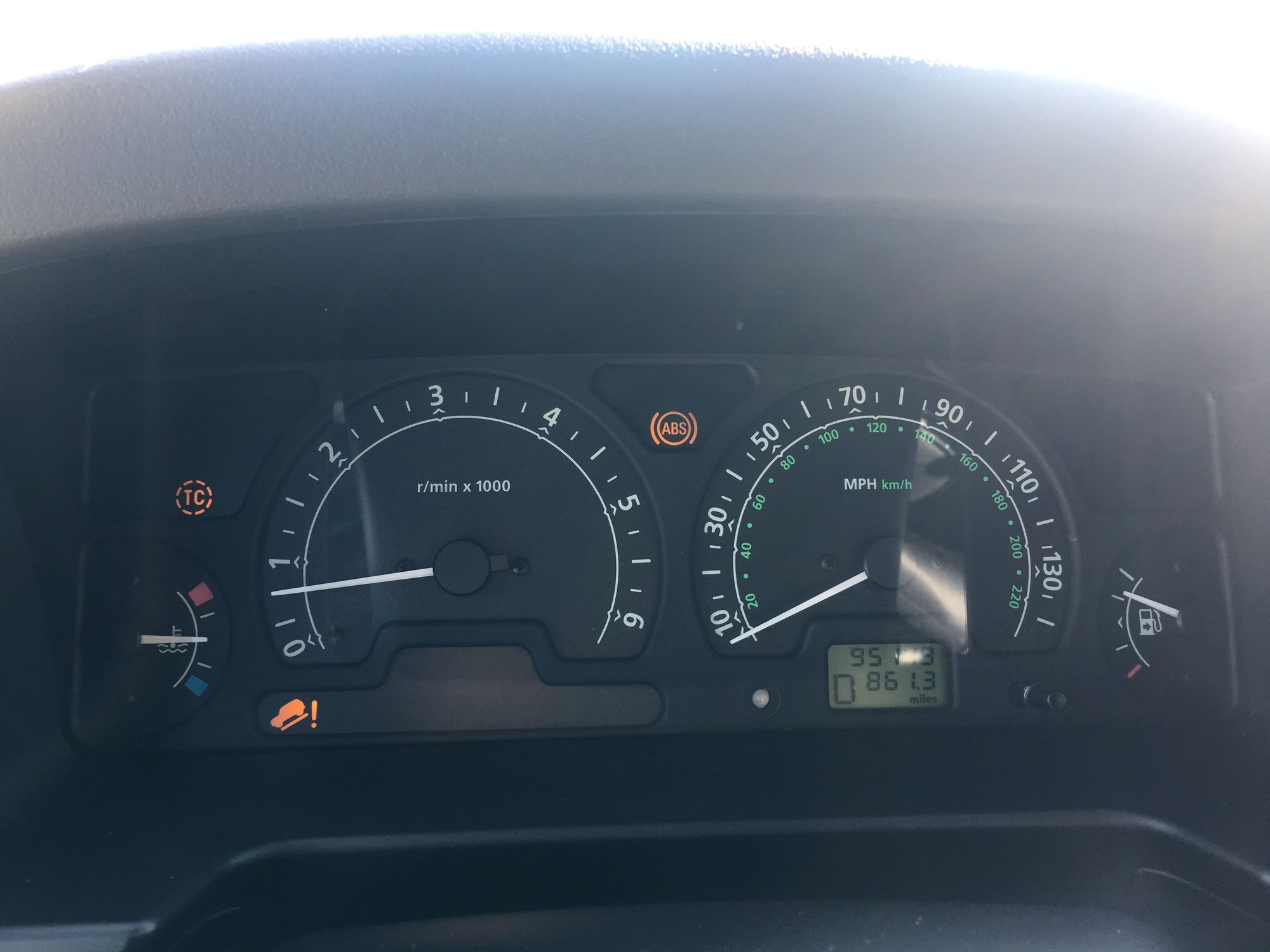

The other day I was driving like normal and as I was slowing down for an exit off the highway, I hear 3 beeps and all of the lights turned on the dash. I turned the truck off and they all went off. On my way home, the check engine light turned on. I ran the code when I got home and it said something about "4th gear being off". I cleared the code and that has not come back on.
The problem with all of the lights turning back on happens at least once every time I drive it. Again, I turn the truck off and they go off.

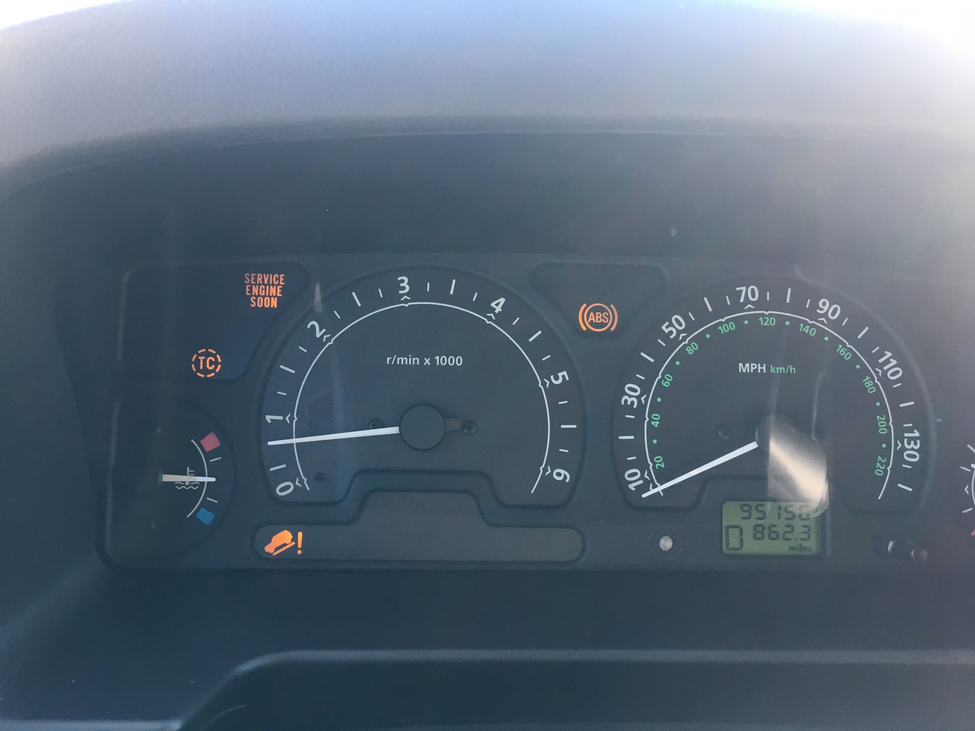

So as I slow down, the 3 lights come on (ABS, Traction Control, and Hill Decent). Then the Service engine soon light comes on. If I turn the truck off, the 3 lights turn off but the Service engine soon light stays on, once I got home, I ran the code and it reads: "P0734 Gear 4 Incorrect Ratio". I clear the code but it will likely come back

oh no, your anti-lock brakes are on the fritz. you possibly have a bad hub or shuttle valve fault with the modulator. your scanner may not read brake codes; if it doesn't then you will have to have the ABS codes pulled with a different device with those capabilities.

Those 3 abs lights come on all the time.....it's a D2. I wouldn't panic about that. The check-engine with the 4th gear thing is a separate issue. Definitely look into that one.
I would suggest you buy an ABS Amigo. either a used one or a new one but they are a "must" for D2 owners. It will clear those lights and also read the codes accosiated with them. A normal code reader will NOT read or clear your Land Rover ABS codes. If you find a place that'll do it, it'll cost you a lot and they eventually come back on for some other reason so get an ABS amigo for sure.
Your ABS will still work fine but you will loose traction control and hill decent. both are not needed unless you are out doing your camel trophy thing.
Most likely the ABS lights are coming on because of a wheel sensor gone bad. They work well but are very very finicky.

The service engine light does not come on until the other 3 do. Once I turn the car off for like 10 seconds, the lights are turned off. (Except the service engine light). They will turn on every time I drive it though. Will the Amigo stop them from turning on and have the ABS system, TC and Hill Decent work as it should?

A device that "clears codes" or removes the fault from the computer only does that; it does not actually fix the problem. After the fault codes have been removed, the ECU will immediately detect the fault, store the code and trip the lamps, once again rendering the system compromised. You have to pull the ABS fault codes, find out what part is going out, replace it and then clear the fault codes. If you don't fix or replace anything and clear the code, it will just come right back.
