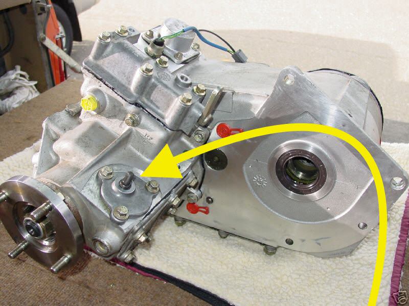

I think the MY 99-01's had the CDL case but no mech to engage them (left over from D1 production) and then brought back in 04'. I could be wrong but I don't thin any of the 03's came with a CDL case
When in doubt, check for the nipple!

Originally Posted by CollieRover
the 2003 may have a TC with the CDL, but not the ability to engage from the cabin FYI. There are kits to add it, but they are $250 if memory serves, and just swapping one with CDL is probably a better option.
I haven't missed it, but mine is a Road Trip/Daily Driver, so I don't miss the locking CDL. I imagine that the Traction Control system will likely get me thru anything I throw at it, if it doesn't I will consider the upgrade then.
