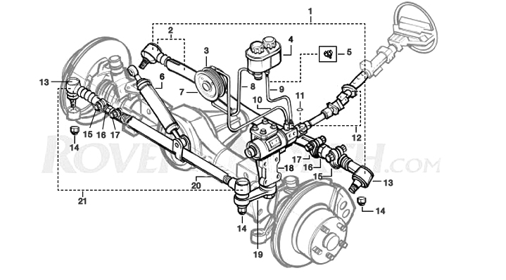

I noticed when sitting still, the steering wheel has play in it. It's not noticeable when driving. I can take it up to 80MPH, no wobble, tracks straight. I saw posts about a death wobble with a DI. Does that apply to DII? Is there a checklist I can run down to confirm what the issue might be? Note: I see a note about "play in the small end of the steering rod" in the dealer service notes from previous owner. (Folder full of service records) What's a steering rod? I learned about the Track Rod and Drag Link for the DII from AtlanticBritish.

Reference material from RoversNorth.com

My 03 drives and handles like a Caddy. You could probably find out where your problem is by calling over a friend or 2 so that someone can sit in the car and turn the wheels while 1 or 2 sets of eyes scans all of the steering components. The parts start at the firewall and go all the way to ball joints on the spindle.
Do a search. There is a thread on this not more than 2 months old. About 3 pages worth of info discussing something similar. Key word "death wobble," "ball joints," "steering." You will learn more searching. It's 6-in-1, half-dozen in the other in regards to this topic. But I can tell you that your setup is no where near OK for a factory LR

Thanks. Good to know that it's not close to normal. Had the wife turn the wheel (engine off, back and forth until it meets resistance) and I couldn't identify just one piece with lots of slot. Just a tiny bit here and tiny bit there.

1. check the complete front end including TRE.
2. could be the steering stabilizer, if its a TF it will never RTC.
3. steering stops come in two sizes i dont remember them off hand.

How many miles on the truck? Your steering box internals could be out of spec. There is a procedure which will allow you to tighten up the slack in the box, but I do not recommend it unless you are qualified to carry out the procedure.

Yeah! It's a TerraFirma, silver with the big blue boot. The damper would prevent/hinder it from RTC right? I should be able to safely remove it and do a test drive, ya?
Is there a good test for TRE? I saw on the forum someone was squeezing them with big pliers?
Steering Stop Info: From what I read, the stops on the '03 are 29mm because mine doesn't have ACE. You can swap these or grind down to 23mm, which is stock for other models. There is a TSB for it - Tech Bulletin 0026 (CDS Ref. L8867bu).

TF dampers are not RTC, throw it out and buy another one.
yes you can swap the steering stops.
can usually tell TRE by feel when rocking them, but i sure there is a test.
