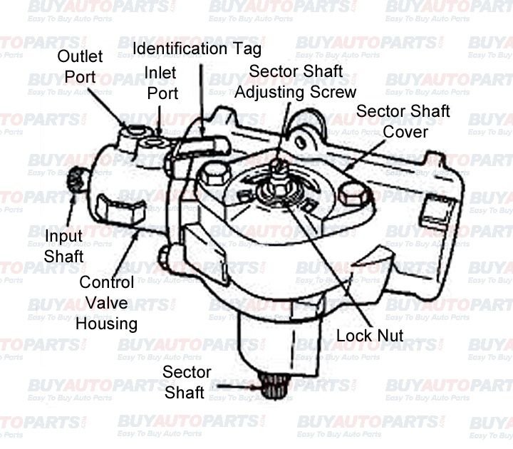

If it is the steering gear box, just make adjustments in small increments. What happens over time and as mileage increases...the center area of of the sector and worm gears get worn in the centered position, from going straight down the road 90% of the time. So, if you over adjust, in the centered position so it feels tight/right, when it gets turned left or right to full locked position (fully turned one direction or the other) it will bind or cause damage to the worm gear that are not as worn in those areas, and could, completely ruin the gearbox.
So, adjust in small increments and turn from side to side, while vehicle is on jack stands and feel for any type of binding. If you feel any binding at all, while in the air, it will be amplified while on the ground...so any binding...back it off slightly.
A generic picture...
Normally, you loosen locking nut on sector shaft and tighten inner protion with screw driver head. Righty-tighty, lefty-loosy. Hit it with some WD40 first.
But, before any of this attempted, check steering shaft joints and coupler, as previously mentioned.
