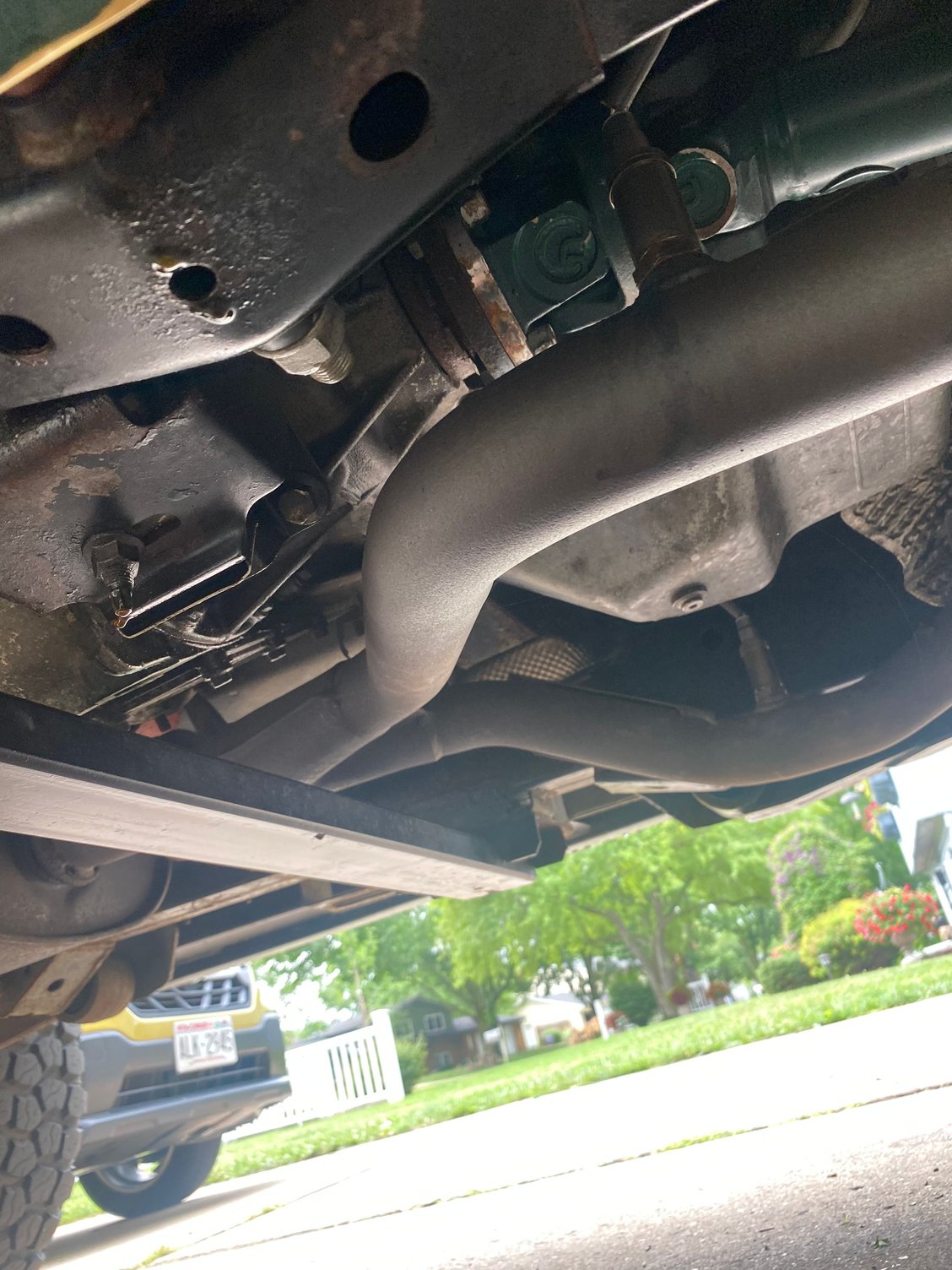

Woke up the next morning to a puddle of coolant dripping down the passenger cats right past the post cat o2 sensor.
Attached is a photo, the coolant has been cleaned up so it isnt that visible in the photo, but on the frame rail you can see the coolant. It def tastes like coolant.
I jinxed myself in the Extinct Mod Post update. Are these the signs of an external HG leaks? Is the next step to pull the heads?

Have you checked/replaced the cap on the reservoir bottle? If they go bad they can sometimes allow coolant out of the overflow pipe when they're not supposed to.

Check the tank and all the hoses too, cooling system dye and a UV light really helps here.

that thought was entertained however I don't have a tube/pipe to redirect the pressure relief of the expansion tank and there were only drips of coolant on the tank. Each refill was about 300- 500 mL so my thought would be that I would see evidence of pressure relief all over the manifold.
I have the pressure tester from AB but I need to identify the adapters required. I believe with that kit I can also test the cap. So I will give that a whirl as well.
I believe the cap is a 16psi cap and per recommendations I have been running with it a half turn full turn backed off.

Will do. I am assuming I can pick that up at any auto store. On initial fill up of coolant I troubleshot a leaking throttle body heater plate as I over tightened the silicon gasket purchased from Basin Rovers. I was kind of bummed as I wanted it to work. Once I put the oem gasket in place the leak stopped.
Visually everything was dry after that minus the dried up crusty coolant on the passenger cat and puddle under the cat.
