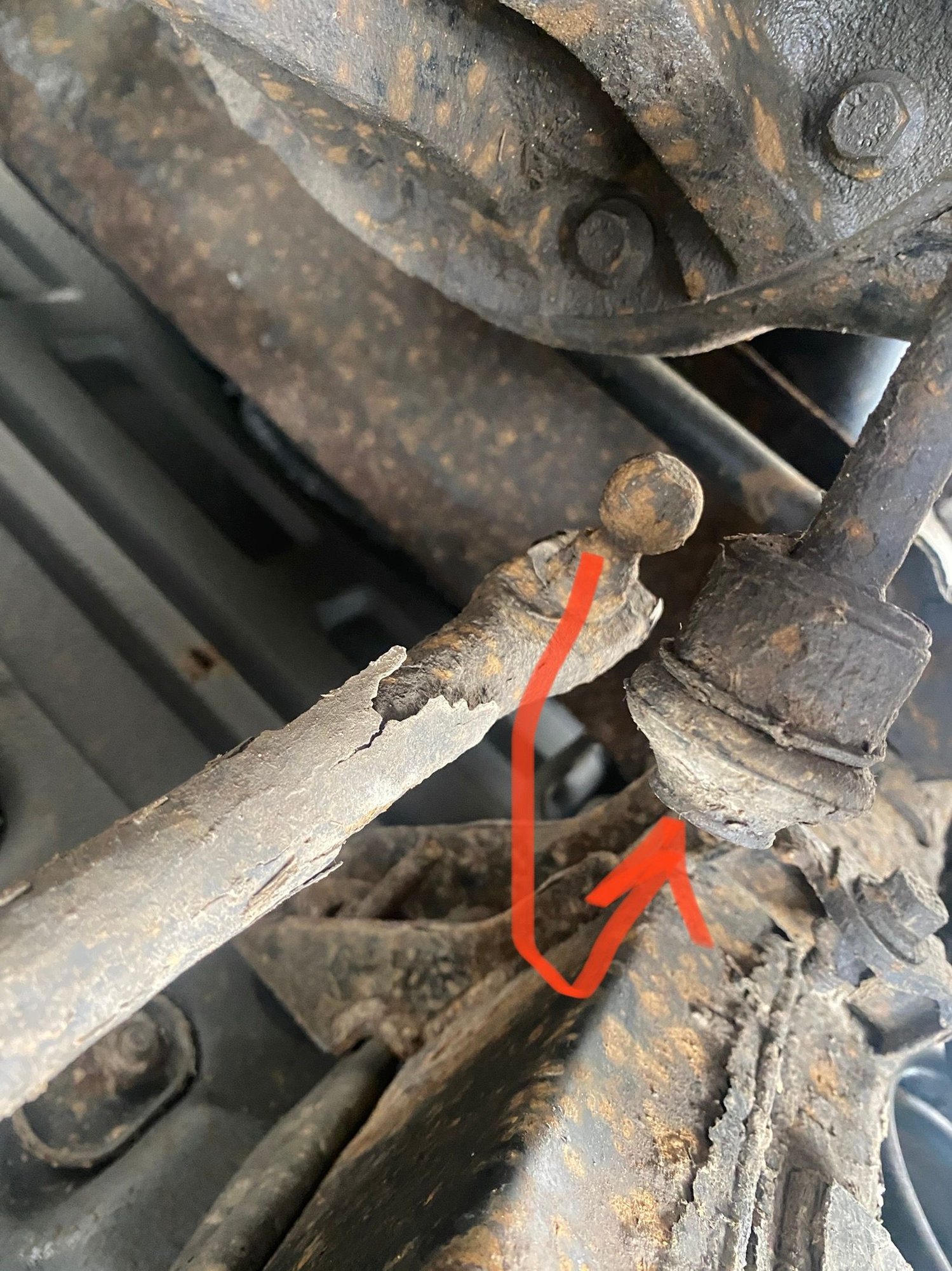

Upon further review - sway bar links it is. Thanks for the tip!

Yes, that sway bar link wouldn't normally make a noise while just moving forward. It would only clunk if it made contact...and it wouldn't be something continuous, normally. Plus, l don't see any contact marks on the two peices. If you have a "rolling clunk or knock"...l'd still be looking at watts link (mounted on rear of axle housing) or roloflex/driveshaft. If nothing jumps out at you there, then drain axle fluid and look for chunks of metal. Check your front driveshaft also, noises can travel underneath.
