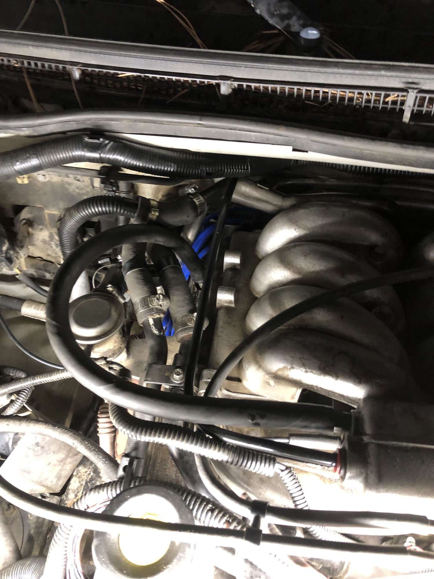

I think I found an intake leak as well. I heard a hissing noise on the valve cover side of the hose that connects from the valve cover to the plenum. Moving the hose seems to change the hissing. I tried tightening the clamps, but that didn't work, so I'll probably order a new one.
Is this hose even the one that is supposed to be for this? It doesn't fit on the valve cover thing all the way, and looks different from the one online.

Which hose specifically is hissing? The larger rubber hose going from the intake to the valve cover, or the thinner smoother plastic piece?
