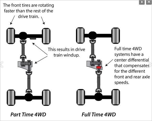

As far as I understand it, a part time 4x4 does not have a differential in the transfer case so when the hubs are locked and the front wheels are driven the system wants them to spin at the same speed as the rear wheels. When you turn, the front wheels spin faster than the rears which is why they feel like they're skipping / binding. It's pretty hard on parts. For this reason, a part time 4x4 really shouldn't be run in 4x4 when there's good traction. The Disco is full time 4x4 so it has a differential in the transfer case allowing for different wheel speed front to rear.

The big difference is that our Discos have a central differential and part-time 4x4s have a transfer case. They aren't the same. The transfer case's job is to send power to both the front and rear wheels when engaged. Some are chain driven, others use gears. When engaged, the transfer case doesn't allow for differing wheel speed front-to-rear when the wheels have traction. If it's not a locking transfer case it will let the front wheels spin if the rears have traction and the front doesn't, and vice versa because power goes down the path of least resistance. However, it won't allow either end to spin faster than the other when all wheels have traction.
I knew a guy that had an old suburban and the previous owner had swapped the rear axle in the past and he didn't know. He found out because he put it in 4x4 and it sounded like the transfer case was going to explode - it was making this awful "clink-crack" sound. It turned out that it had 4:10s in the rear and 3:73s in the front. Since the transfer case doesn't allow for different wheel speeds front to rear it sounded like it was going to explode. There's a show called Dirt Every Day where they had this happen as well. It was a square body Chevy that they took on the Rubicon. If you want to hear what an angry transfer case sounds like, that's a good episode. It's season 7 episode 11. They find that the front and rear have different gear ratios on season 9 episode 13.

Hopefully this helps show the difference. I got this image from https://www.mri-auto-diagnostics.com...-differential/
