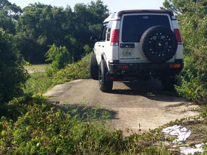

I also put 20s on with the same lift and couldn't be more happier. It was a nightmare trying to get any information about if they would work. But it looks good. I went with a 275/60r20 with a -27 offset. I was in the mud last weekend and surprisingly it still never got stuck. I also just got back from a trip to south Florida pulling a boat and other than 11 miles to the gallon everything went fine.
I saw your post a while back when you installed these! I like it!
I experienced the same thing, nobody had any idea if it would work, when I asked, people just told me what a stupid idea it was.
These RRS wheels are 20"x9.5" with +53MM offset. I also went with 275/60r20's but the AT3's look a little taller than whatever you have on there.
I'm actually glad I got an OEM with a large positive offset, the axle+hub width on these trucks requires a large positive offset to keep the wheels from sticking out super far. I'm surprised you can turn AT ALL!
I still need to replace several things to get better results from the lift, Bump Stops, Adjustable Pan Hard, Radius Arms, Brake Lines, ABS Extenders, Watts Linkages, Control Arms, Bla bla bla... Maybe in due time, but for now I'll try to avoid crazy articulation and enjoy the nice ride.
Edit 1: I've been curious, those who install 33's on the 4.0 DII's with stock gears must be in for a mighty slow truck... From driving stock 4.0's and 4.6's there's a significant difference! Especially in the low end.
